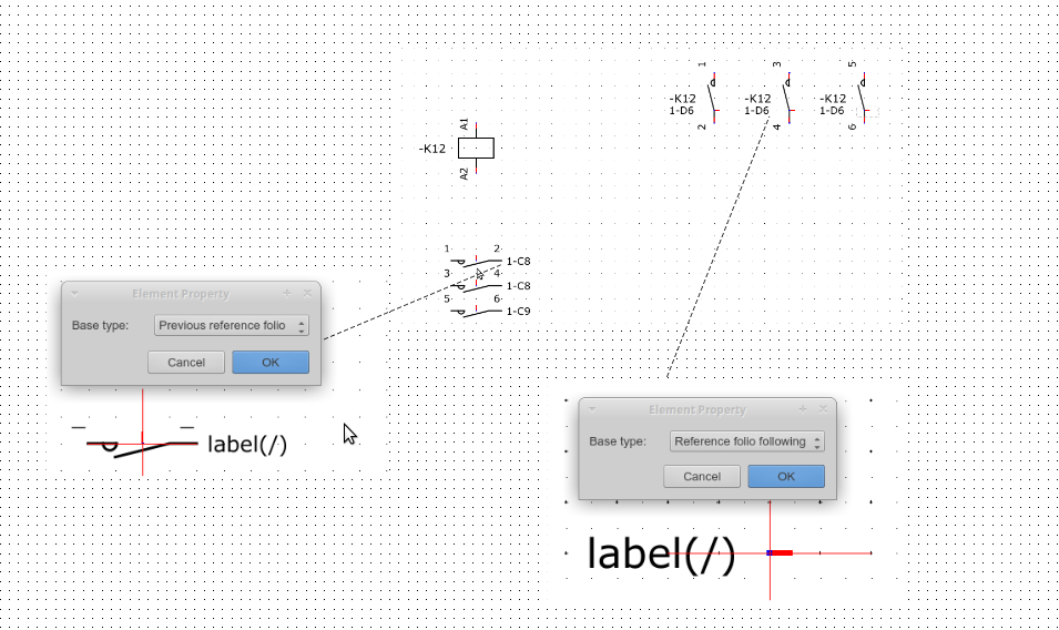

Hello
First you create an element for the contact mirror (contact NO), insert a label and as a component property incoming filing reference.
For the contact in the plan you create an element add a label and as a component property outgoing foil reference. In the plan, you can use them as references from conductors.
I'm trying to make a screen photo. The video is too big
Best regards
Stebo
Edit: The relay coil has no relationship with the contacts. Only the references are connected to the elements

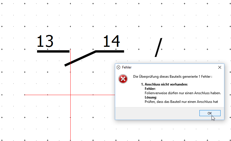

I can't create a component as incoming/outgoing foil reference without having a connection in the component. See attached screenshot. Is this right?
Best regards
piceaabies

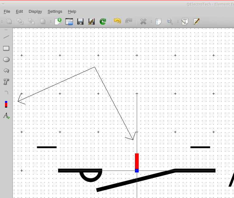

7 (edited by Calypso 2017-01-06 22:04:10)
Re: Manage terminals
Hello
The element needs a terminal that is the red bars. The terminal is only an insertion point for this element to store it
Best regards
Stebo
