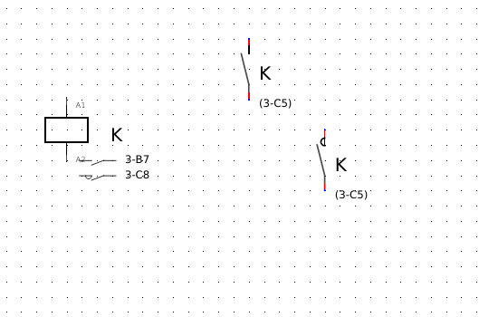

I can link coils and contacts.
It seems though, that power contacts are not listed under the coils, see picture.
I guess that is a bug?
Can i edit the contact element somehow to get it working?

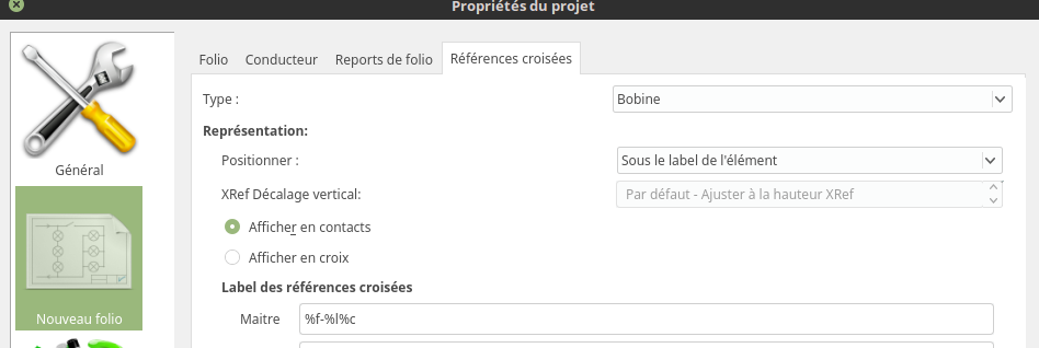

You have to change style about xref in project setting :

Here:
