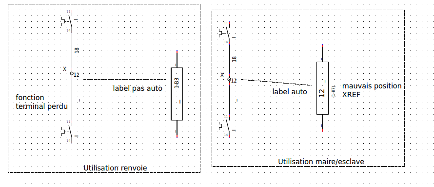

It's not better ... Xref is not at the good place....

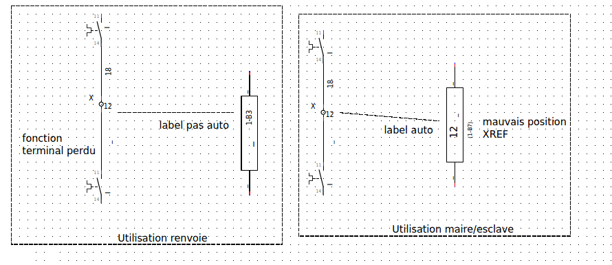

Re: elements linked
Yes, I try slave/master fonction, the problem is : with slave/master, Xref is not at the good place.

Re: elements linked
in master slave like you did the position of the xref is dependant of the tagg label.
So we have to ask development to have this position set in another textfield with a taggname XREF, this would be a better option , as we can set the xref wherever we want it. (not at pagebottom but that is covered in software already)
In this same thing i would like to have we can choose what icon will be at master like a NO, NC, Power, EMPTY, safety, so this will need another directory with entries (a bit like references is now)
I will make an example on this for laurent and others ( as it is in line with these references i am making)
