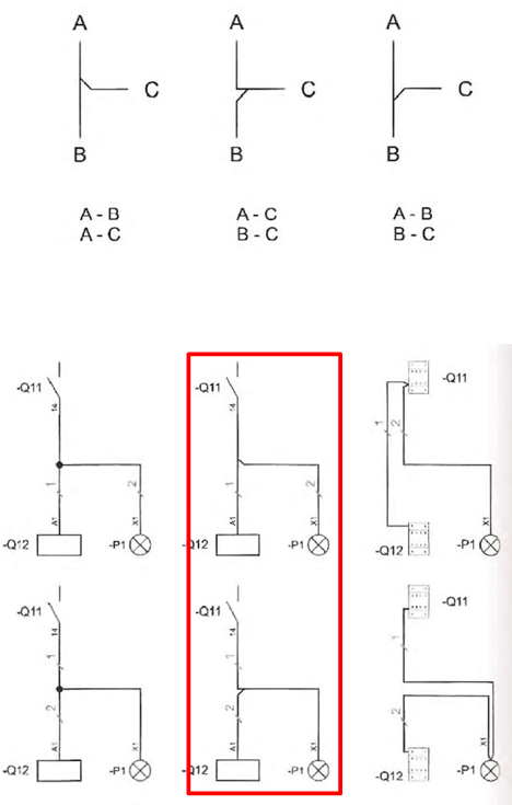

Hello everyone. I don't know if anyone has asked anywhere on the forum how to join conductors to identify which component specifically joins one conductor to another. I am attaching an image with different joins.
Thanks in advance.

this has nothing to do with the application
you can control this by using a splice
If it is purely for having a shematic I would leave the control to the application
if you want to indicate how the wiring should be I would put a splice
Anyway suggestion 2 is to avoid
and the the choise for 1 or 3 depends on the components where the wires need to be connected
if it is possible to put 2 wires into one connection
