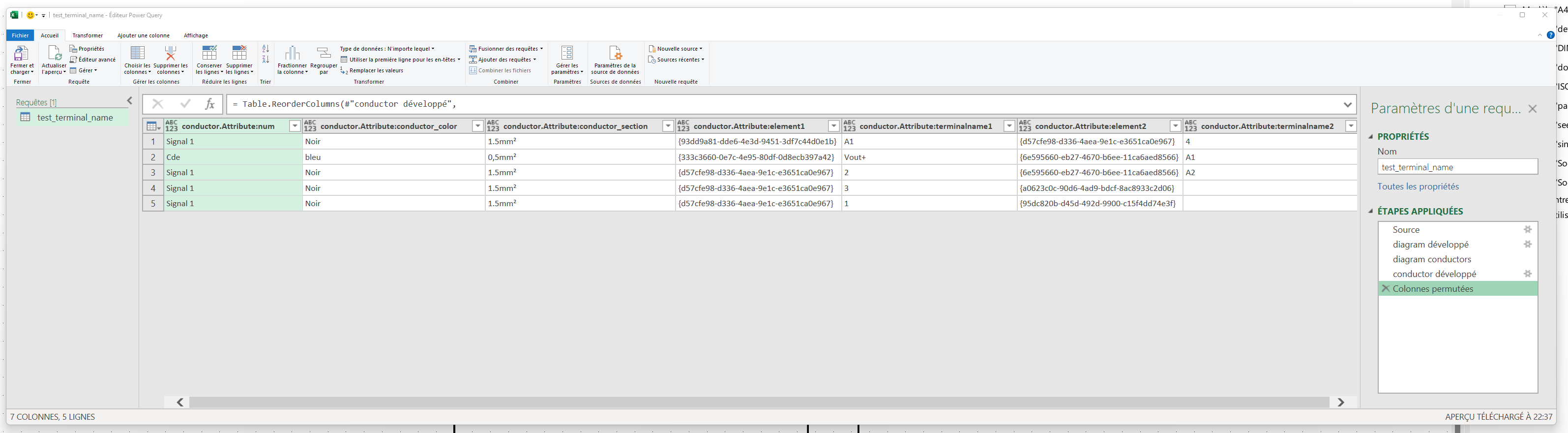

6 (edited by qmcc 2024-06-17 23:42:20)
Re: Nomenclature filerie
Merci plc-user et scorpio810 pour votre aide !
scorpio810: Un petit dessin dans un code est plus pragmatique que 3 pages d'explications nomicons/smile
J'ai importé mon fichier .qet dans Excel en passant par l'Editeur Power Query pour "parser" le texte xml,
puis je récupère dans Excel les informations qui m’intéresse sur les conducteurs.
Encore un peu de mise en forme dans Excel et ça devrait etre bon.
Attachment icon Capture d'écran 2024-06-17 231943.png 144.19 kb, 121 downloads since 2024-06-17

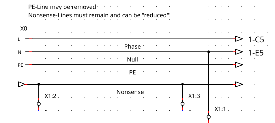

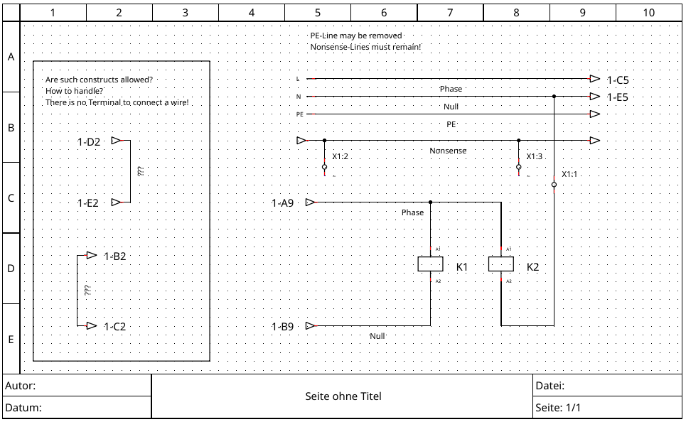

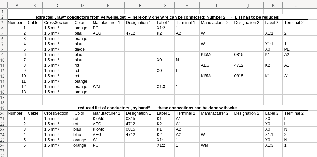

In my opinion, we should not add so much information to the connections that is already in the QET file for the elements anyway. This only unnecessarily bloates the file...
And it doesn't make the biggest problem any easier: connections with coming and going references.
I have attached a file that shows at least some of the problem cases. It looks quite simple at first glance, but as I said, it's not trivial! Take a look at the connections in the QET file: So many connections in the QET file, but only six wires that can be connected. These have to be sorted out automatically!
Just to clarify what the original task is:
We want to create a wiring diagram, or rather a text-based wiring list, for the electrician so that he can see which wire he has to pull from where to where, isn't it? For example:
"Pull a 1.5mm² green wire from K1 terminal A1 to lamp H1 terminal 2."
References are no terminal points to which wires can be connected...

Hello everyone!
In my previous posts only raw data was shown as output. That can be a little confusing...
The programming exercise has continued and now the output is a little clearer. I have now attached a screenshot of LibreOffice Calc in which the unprocessed connections from the file "Verweise.qet" are listed at the top. I have assigned a few names and labels before. Some designations of terminal blocks are still missing, but I think you can see, what's the plan...
In the lower half, I have inserted a manually edited list of how I imagine a cable plan should be automatically reduced from the raw data.
The requirement for this is that all terminals of all elements used in the QET-file are provided with UUIDs and names! Only then, in my opinion, can such a list be automatically generated and meaningfully reduced.
Bildschirmfoto_Calc-Ausschnitt.png, 77.39 kb, 1010 x 500

In my programme I already have all the information available that makes up a connection. That includes all information about the connected elements. The challenge I see at the moment is figuring out the logic of which connection I need to change and how, in order to be able to delete another connection.
From the file "Verweis.qet":
The PE connection can be deleted without any substitution, because on the one side there is a component (X0.PE) connected, but on the other side of the connection there is only a reference that does not point anywhere and also has no second connection.
The situation is different with the " Nonsense" line:
From X1:2, a connection goes to the left to the link that points nowhere. However, the line must not be deleted because a second connection is attached to the left reference, which goes somewhere. I therefore have to transfer the data from the second connection to the connection to X1:2 in order to be able to delete one of the two connections.
You have to move from point to point in order to delete as many connections as possible. Ideally, no reference element will remain at the end.
The situation is similar for the "Phase" and "Null" connections, which go from X0 to K1 and K2.
