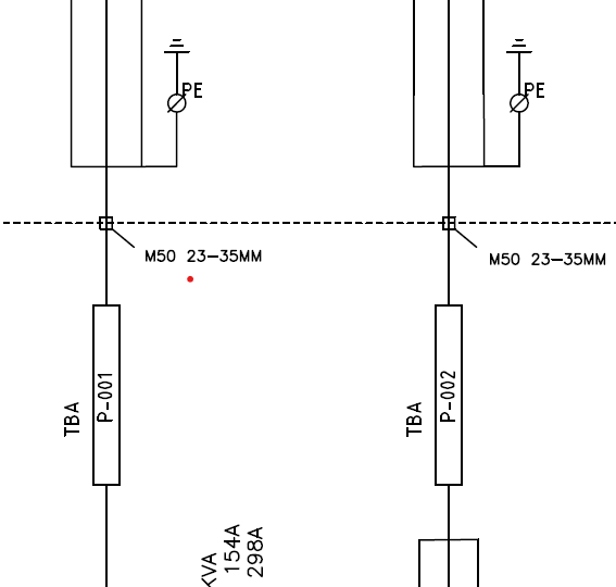

I'm not very experienced with QElectroTech or wiring diagram programs in general, but I'm wondering if it is possible, in QET, to draw a cable as a single line and split it out into the individual wires, similar to busses split out into individual connections in electronic schematics?
Something similar to the attached screenshot.
I've tried to do some searching, but I haven't found an answer.

Thank you.
I saw your first post earlier and tried the cable elements, but they seem to not have any terminals for wires, and my knowledge of French has some gaping holes... :-)
I, after my first posting, found the element shown in your second post, and I have used this, but slightly modified for my use (to not take up so much space).
