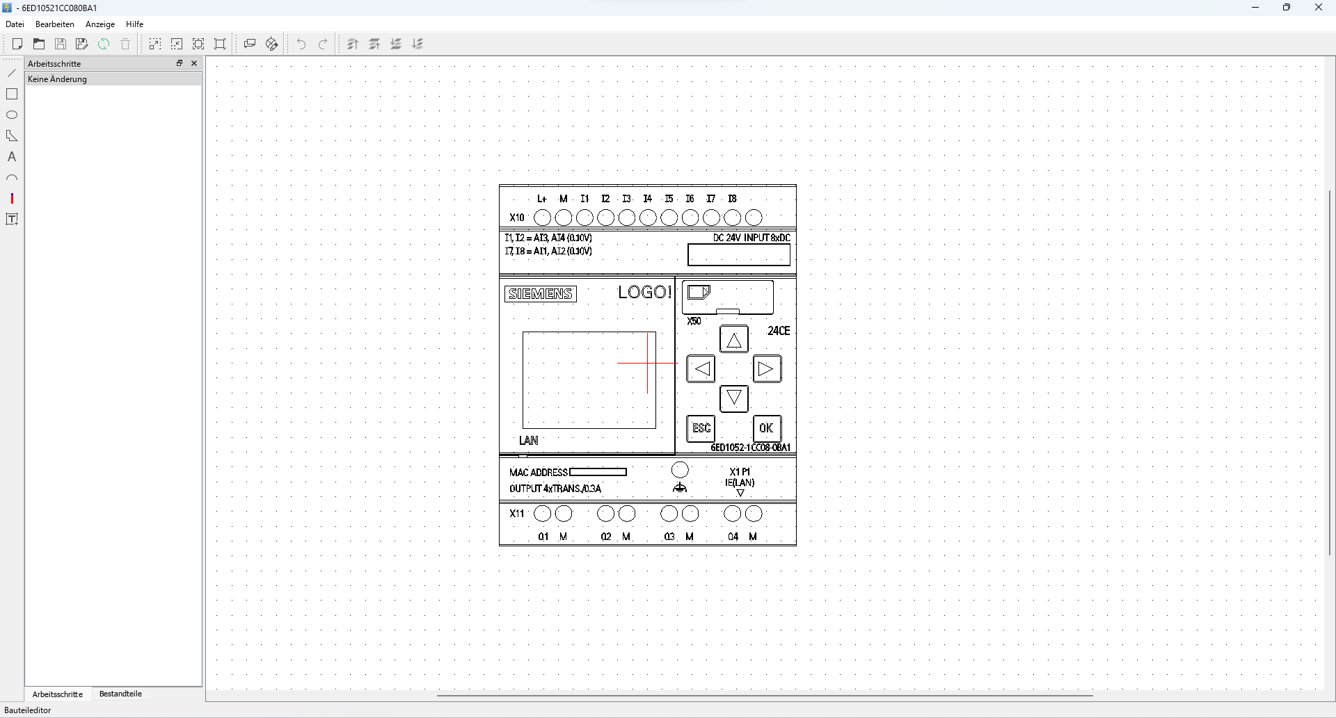

Hi there,
Im trying to create an overview page for my PLC (Siemens logo!).
So i downloaded the dxf files of the devices im using and used the dxf to element plugin.
After creating the new elements I saw that they were too small. Now I am wondering if there is a way to make an element a specific size (not just eyeballing it with the green dots in the editor).
I need them to be the same size because I also need some extension modules for the logo.
I could make the Logo CPU + extension module in one element, but then I would need a new element for each configuration.
Screenshot 2024-01-17 101615.png, 41.37 kb, 1920 x 1033
Re: is it possible to scale elements to a specific size?
see https://qelectrotech.org/forum/viewtopic.php?id=1946
Siemens Logo is in QET collection -> https://download.qelectrotech.org/qet/e … index.html
https://download.qelectrotech.org/qet/elements/10_electric/20_manufacturers_articles/siemens/01_PLC_controllers/logo/siemenslogo230rce.svg
