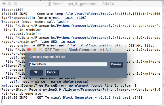

8 (edited by peter_smalley94 2023-02-22 12:02:46)
Re: Problem with install get_tb_generator on macOS
I have an issue where terminal Block plug in runs seperatly from Qelectrotech but it wont run properly or thought the Qelectrotech program. I know the correct file path is being used it jsut cant search it.
Screen Shot 2023-02-22 at 08.14.58.png, 105.75 kb, 578 x 372
Hi Peter,
when you have installed python 3.9 bundle have you also added python PATH in your zsh profile?
BTW, for my personnal information what QET version use you, intel or arm64 version?

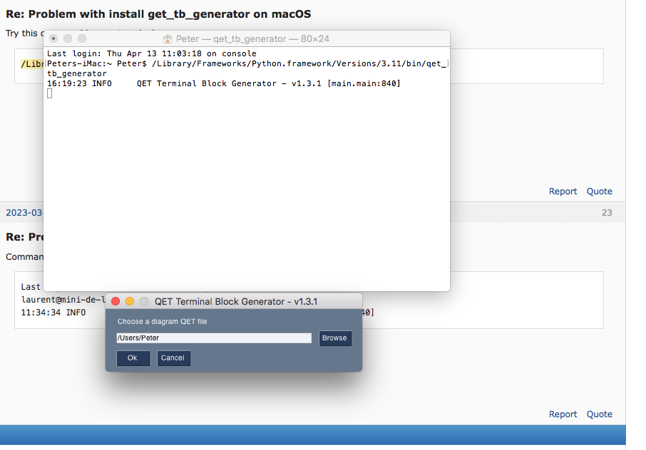

Try this command in your terminal:
/Library/Frameworks/Python.framework/Versions/3.11/bin/qet_tb_generator
When i put the command in my terminal this comes up:
