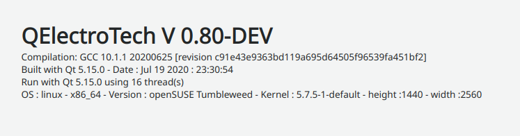

test:
    QScreen *screen = QGuiApplication::primaryScreen();
    QRect  screenGeometry = screen->geometry();
    compilation_info += "</br> - height :" + QString::number(screenGeometry.height());
    compilation_info += "</br> - width  :" + QString::number(screenGeometry.width());
Screenshot_20200719_233312.png, 38.1 kb, 747 x 196
Re: Resizing of border line of software
Wrong values..

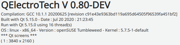

this code works.
    compilation_info += "<br>  *** Qt screens *** </br>";
    const auto screens = qApp->screens();
    for (int ii = 0; ii < screens.count(); ++ii) {
      compilation_info += "<br> ( "
              + QString::number(ii + 1)
              + QString::number(screens[ii]->geometry().width() * screens[ii]->devicePixelRatio())
              + " x "
              + QString::number(screens[ii]->geometry().height() * screens[ii]->devicePixelRatio())
              + " ) </br>";
Screenshot_20200720_212901.png, 36.06 kb, 594 x 151
#include <QScreen>
QElectroTech V 0.80-DEV
Compilation : GCC 9.3.0
Built with Qt 5.12.5 - Date : Jul 20 2020 : 21:31:12
Run with Qt 5.12.5 using 48 thread(s)
OS : linux - x86_64 - Version : Debian GNU/Linux bullseye/sid - Kernel : 5.7.9-vanilla
*** Qt screens ***
( 1 : 3840.2 x 2160.6 )
( 2 : 1920.1 x 1080.3 )
Great! if you can push it?

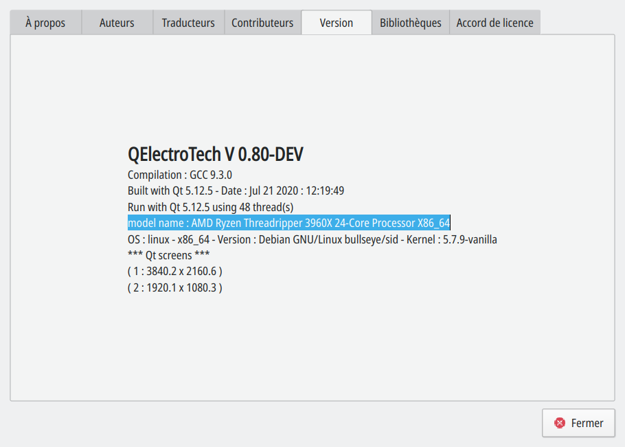

Add Linux cpu info 'model name'
#else
    compilation_info += "  GCC " + QString(__VERSION__);
    compilation_info += "<br>Built with Qt " + QString(QT_VERSION_STR);
    compilation_info += " - Date : " + QString(__DATE__);
    compilation_info += " : " + QString(__TIME__);
    compilation_info += " <br>Run with Qt "+ QString(qVersion());
    compilation_info += " using" + QString(" %1 thread(s)").arg(QThread::idealThreadCount());
QProcess linuxcpuinfo;
         linuxcpuinfo.start("bash", QStringList() << "-c" << "cat /proc/cpuinfo | grep 'model name' | uniq");
         linuxcpuinfo.waitForFinished();
         QString linuxOutput = linuxcpuinfo.readAllStandardOutput();
    compilation_info += "<br>" + QString(linuxOutput.toLocal8Bit().constData());
    compilation_info +=  QString(QSysInfo::currentCpuArchitecture().toUpper());
    compilation_info += "<br>" "  OS : " +  QString(QSysInfo::kernelType());
    compilation_info += "  -   " + QString(QSysInfo::currentCpuArchitecture());
    compilation_info += " -  Version :    " + QString(QSysInfo::prettyProductName());
    compilation_info += "</br>" " -  Kernel :     " + QString(QSysInfo::kernelVersion());
                 + " x "
                 + " ) </br>";
#endif
#endif
cpuinfo.png, 63.33 kb, 910 x 650

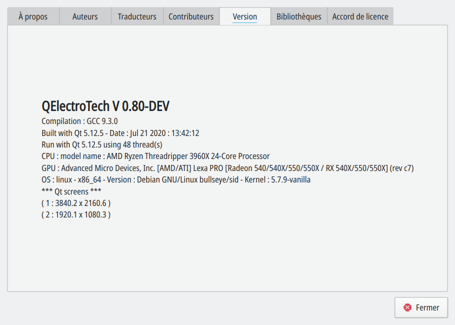

Add Linux gpu info 'model name'
QString OSName = QSysInfo::kernelType();
    if (OSName == "linux")
    linuxcpuinfo.start("bash", QStringList() << "-c" << "cat /proc/cpuinfo |grep 'model name' | uniq");
    compilation_info +=  "<br>"" CPU : " + QString(linuxOutput.toLocal8Bit().constData());
    QProcess linuxgpuinfo;
    linuxgpuinfo.start("bash", QStringList() << "-c" << "lspci | grep VGA | cut -d : -f 3");
    linuxgpuinfo.waitForFinished();
    QString linuxGPUOutput = linuxgpuinfo.readAllStandardOutput();
    compilation_info += "<br>"" GPU : " + QString(linuxGPUOutput.toLocal8Bit().constData());
gpuinfo.png, 74.4 kb, 910 x 650

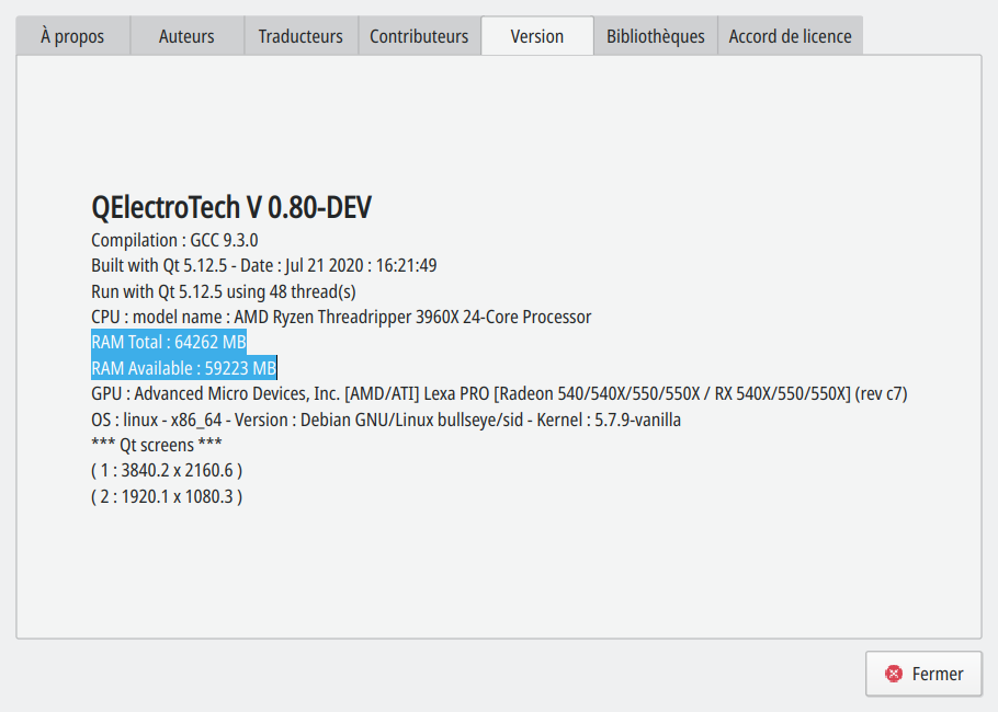

@Simon,
if you could try this patch on Windows?
Attachment icon 0001-AboutQETDialog-try-to-add-cpuifo-model-name-and-AM-T (1).patch 1.76 kb, 400 downloads since 2020-07-21
ram.png, 80.97 kb, 910 x 650
