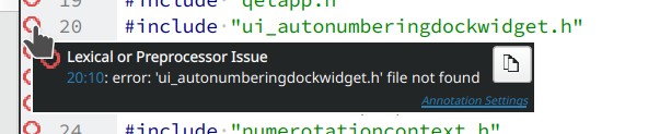

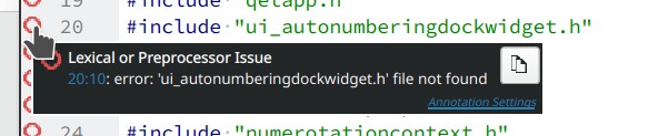

I am currently working on fix preprocessor Issue error: 'foo.h' file not found
this provides the in QT editor linking.
Screenshot_20200529_211552.jpg, 24.87 kb, 592 x 123
