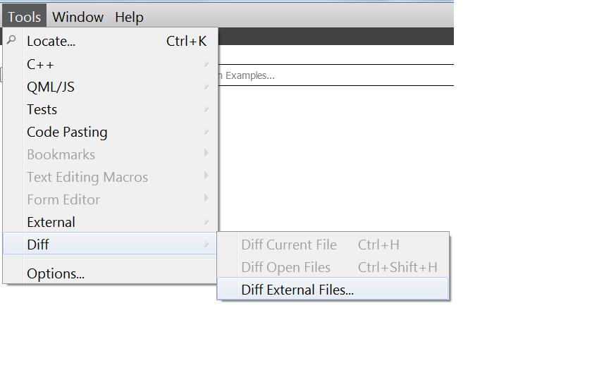

Hi laurent,
In qtcreator tools menu have I not Subversion.
Erik
See my notes here :
https://qelectrotech.org/wiki_new/doc/qt_creator
In qtcreator go to Tools -> Version control, open Subversion tab, add /usr/bin/svn in command field (for Debian like).
Bonjour
Ne pas avoir le menu SVN , mais svn est installé.
Hello,
Do not have SVN in tools menu, but svn is installed.

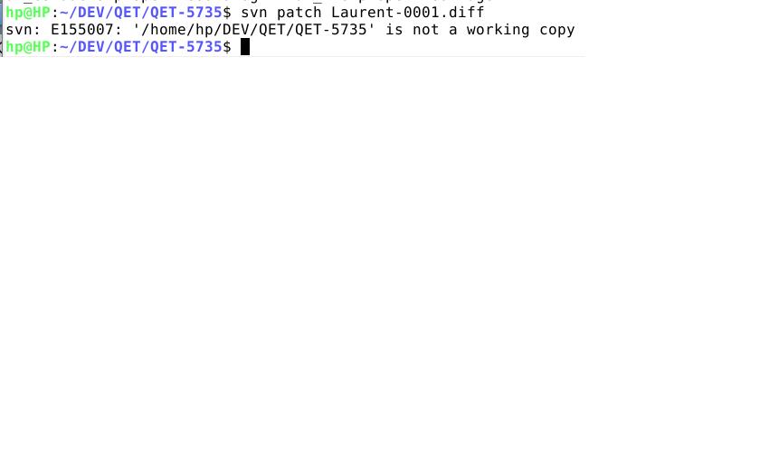

Je suis avez des problèmes pour installer le fichier patch
Hello,
Have problems installing the patch file
Get latest sources by :
svn checkout svn://svn.tuxfamily.org/svnroot/qet/qet/trunk trunkNow you can create new qtcreator project -> select your path to your folder -> trunk/qelectrotech.pro
If you want to apply a patch :
Go to your trunk folder and add patch file.
Apply patch command in terminal ;
svn patch your patch_file.diffRun qtcreator and recompile sources.
