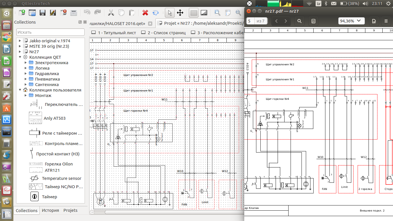

Dear, can not you do anything neater? At me in all old projects the numbering on "Terminal block". If it is impossible to return the old numbering, then give advice on how to find it. It's good that I save files in PDF format for some projects.
СМОЌПк экраМа Пт 2017-03-23 23-11-01.png, 257.36 kb, 1366 x 768

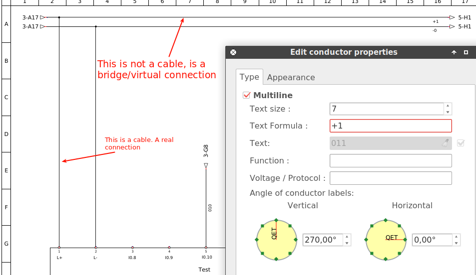

I don't understand why you want to have 2 differents xref on terminal ?
What i know about electrical schematic, xref on terminal is the position about him, no ?
About clamp, I think, it's shoul be more simple : If I want to have 2 terminal side by side and connected by "clamp", I draw 2 terminal with same potential at the bottom or top and two consecutive number.
Every terminal at the terminal strips no implies that is drawed previously in the diagram. You could draw a lot of conductors to  a +1 potencial, but you are not drawing the terminal element. The xref for every side of the terminal strip is the xref of the elements that are connected.
Implicit connections end with a dot '.'
About clamps, is possible to have a connector on the electrical box that could be use as option by the final customer. In this case you only need to draw the male or female part.
Maybe you mean thas is not necessary that the script generates the MALE and FEMALE parts?

Yes, now in some projects I can not restore the numbering

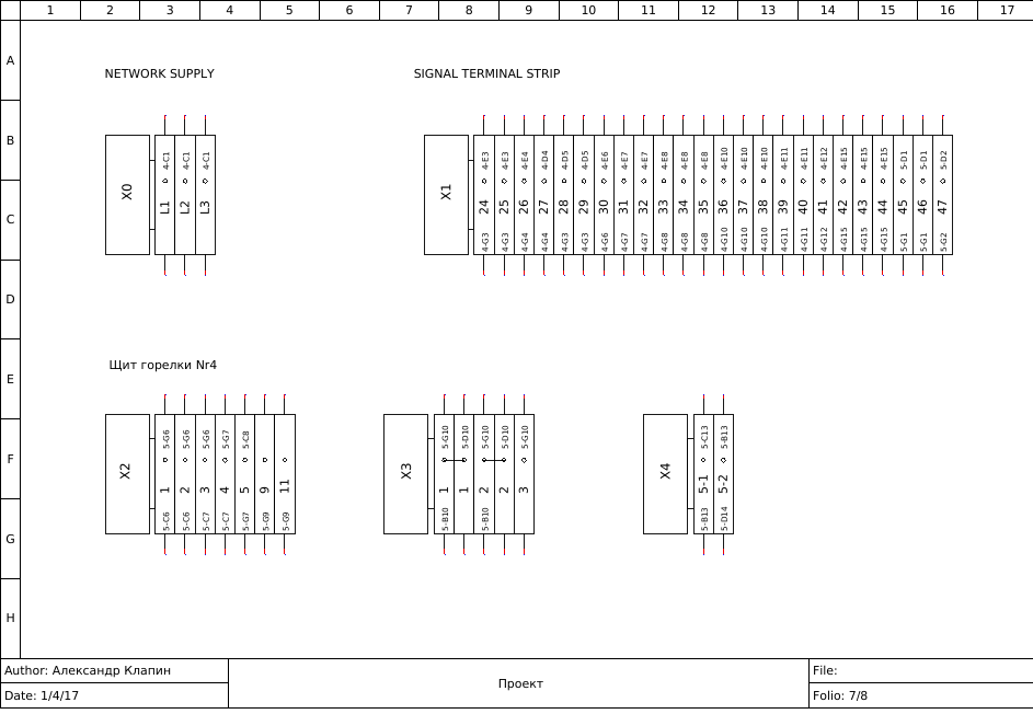

Hi Aleksandr, I edited your diagram and I post a sample result.
sample.png, 36.91 kb, 943 x 652

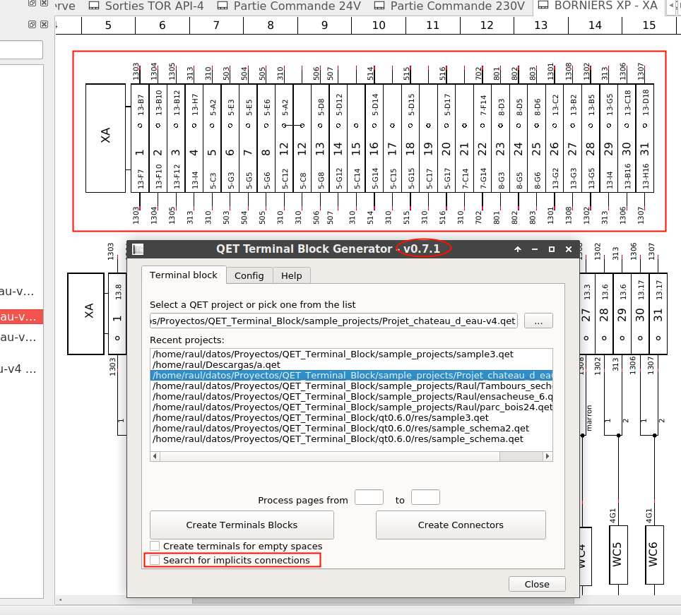

 * if "search implicite connection" is disabled, then the xref for the terminal block will be showed.
  * if "search implicite connection" is enabled, then appears the xref for connections in every terminal block's side.
I've checked diferent options to implement teminal block in QET and maybe an option is allowing to define when a conductor is a bridge. Maybe adding a checkbox in the conductor properties dialog. This will be a easy way to create terminal blocks.
023.png, 49.38 kb, 953 x 552

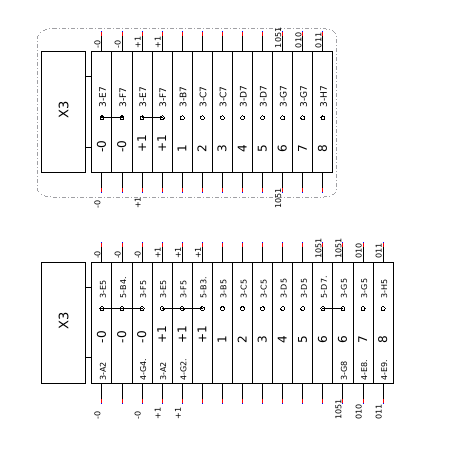

The picture shows the differences between the TB:
tb.png, 18.49 kb, 450 x 449
