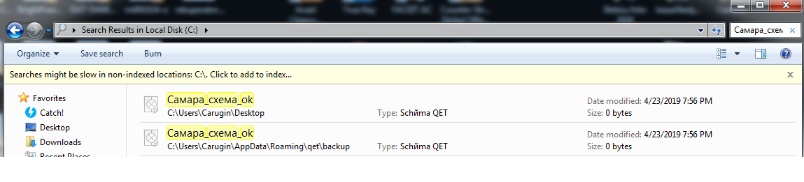

Thanks for the answer. It worries me that after this error, the project no exists. He is removed and there is no possibility to return it.File size is set to zero.

Randomly. Last time happened today, when I wanted to do print project.I have a problem like christophe.lemaitre. In his topic, I attached a photo that happens to the project after this error.

The first time I was lucky that two projects were opened at once. I was able to restore it through the second project. After that, I began to make copies of the project.
As I wrote at the beginning. After this error, the size of the project becomes zero. I understood, that this problem is not only me.

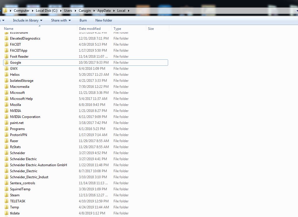

You could see in this directory :
C:\Users\Carugin\AppData\Local\stalefiles\QElectroTech
Checked appdata folder and there is no stalefiles folder.

Today I worked all day with the program. There were no errors.As for the directory, I cannot find this folder anywhere.:)Maybe I already became blind.
You started well your Carugin session, and not a public user?
I tried on Win10, Win7, ReadyToUse and installer and I always saw stalefiles\QElectroTech when a project is loaded.
Edit : stalefiles folder on Users/User_name AppData Local exist only on 0.7-Rc1, not in 0.6X versions.
