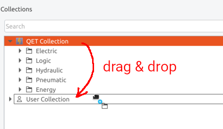

you can not edit the elements provided in the QET collection. They are in read-only mode.
If you want to edit these elements, please drag&drop the whole QET collection into the user collection (from the collection panel).
