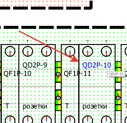

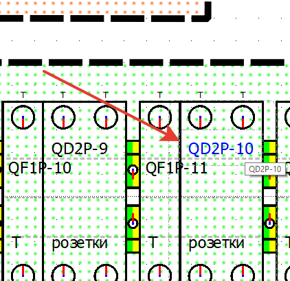

I used to direct an element, and if its ID is a link, then it was glowing blue. Now this is not. Can this be customized? I wanted a bright red in general, but there is not any at all)))

if the item has a link, then the label turns blue when you hover the cursor. But in 0.7 it is not, the label remains black. And this is not convenient, it is not clear where there is a link, and where not.
