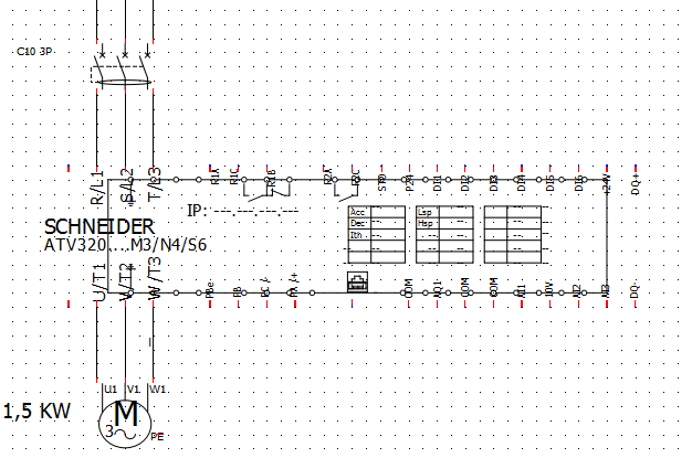

When I insert a new component, all the terminal pins are displaced. (As you can see in the attached file.)
Does anyone have a solution for this problem?

Re: Displaced terminal pins
Hello,
strange, perhaps hotpost element wrong?
Does this happen only on a specific element?
What your OS and QET version?
Could you provide this project?
Thanks.
I don't see any problem here on my Debian machine with your project.
Perhaps a Windows graphic driver's problem or machine so old?

i know this thread is bit old, but i have same problem here. I have just learnt to know QET and spent some hours on it untill getting stuck with this issue.
I am using Windows 10 and QET 0.7.
I can reproduce this issue on my second/third monitor. If i work with my laptop monitor, then it will be fine. Perhaps there is something that QET shall acknowledge automatically the display resolution? Just an idea..
Thanks anyway, keep the good work!
Hello Rajamodol,
thanks for this informations that can be help us.
It seems that some people only have problems under Windows (10 ?) with several screens, but we have no information on the configurations and type of these screens.
Here on my Debian Sid with 2  X 27" screens  one in 4K (3840 * 2160) and other in 2K (1920*1080) I saw no problem.
Is maybe a MS Windows 10 problem, I don't know?

i just played little bit to localize the issue. If i change "Change the size of text, apps, and other items" on display setting to another value as my main monitor, then the issue will be there.

interesting, thanks for your feed back.
You have UHD (4K) screens in your config?
https://cullmann.io/posts/kde-qt-highdpi-scaling/
