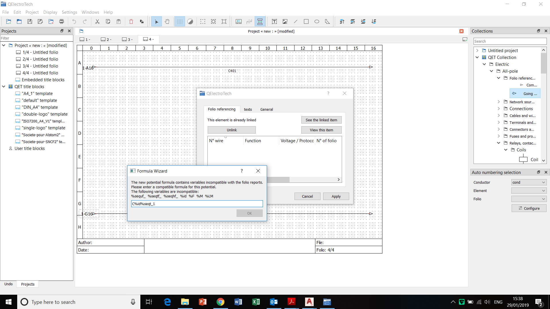

Changed to win10 + very fast cpu. The numbering scheme sort of works (when you right click on the folio referencing menu - not shown on the video) but I am getting the following error message pop up after selecting which wire to link and that the two conductors become one number.
Formula Wizard
The new potential formula contains variables incompatible with the folio reports.
Please enter a compatible formula for this potential. The following variables are incompatible etc etc

You could send your project, or a screen?

Enter a empty formula in the popup fix your problem when you link conductor to report folio.
Remove link an link your report again to save the same potential otherwise the potential is wrong.
BTW, conductors dynamic formula isn't the good idea for connect differents conductors potentials with a formula by report folio.
