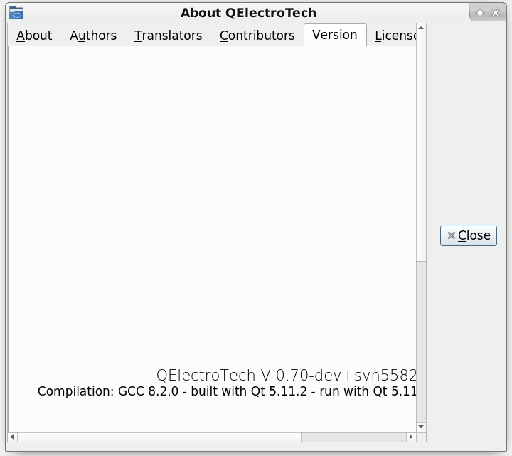

j'ai changer le withsize dans sources/aboutqet.ccp
voir les photos
Dans le fichier aboutqet.cpp, les éléments suivants ont été modifiés.
À la ligne 37; setFixedSize (700, 600); photo 1
à setFixedSize (1200, 600); photo 2
Dans la ligne 61; scrollArea->setFixedSize (590, 590); photo 1
à scrollArea->setFixedSize (1090, 590); photo 2
i have change the withsize in sources/aboutqet.cpp
see pictures
in the file aboutqet.cpp the following has changed.
In line 37; setFixedSize (700, 600); picture 1
to setFixedSize (1200, 600); picture 2
In line 61; scrollArea->setFixedSize (590, 590); picture 1
To scrollArea->setFixedSize (1090, 590); picture 2
photo 1, picture 1
QET-5582-aboutqet-jpg.jpg, 73.08 kb, 720 x 641

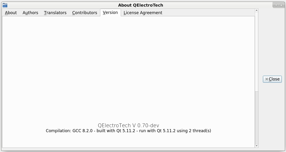

Re: Compiter ; Compile QET
Photo 2, Picture 2
QET-5582-aboutqet-with change.jpg, 88.31 kb, 1215 x 644
Thanks,
diff --git a/sources/aboutqet.cpp b/sources/aboutqet.cpp
index .. 100644
--- a/sources/aboutqet.cpp
+++ b/sources/aboutqet.cpp
@@ -34,7 +34,7 @@
     QDialog(parent)
     setWindowTitle(tr("À propos de QElectrotech", "window title"));
-    setFixedSize (700, 600);
+    setFixedSize (1200, 600);
     //setMinimumHeight(600);
     //setMinimumWidth(600);
     setModal(true);
@@ -58,7 +58,7 @@
     QScrollArea* scrollArea = new QScrollArea(this);
         scrollArea->setWidgetResizable(true);
-        scrollArea->setFixedSize (590, 590);
+        scrollArea->setFixedSize (1090, 590);
         scrollArea->setWidget(tabs);
Have you tried it on litle screen ?
@scorpio810 : Have you tried it on litle screen ?
Yes, (Qui) nomicons/smile
16:9 screen (écran)
1280 X 720 ; HD-ready = tv
16:10 screen ( écran)
1680 X 1050 ; my maximum screen size ; ma taille d'écran maximale
1440 X 900
1280 X 800
Revision: 5589
Author:   scorpio810
Date:     2018-11-12 17:07:52 +0100 (Mon, 12 Nov 2018)
Log Message:
Change in aboutqet widget fixed size, thanks Re-searcher
