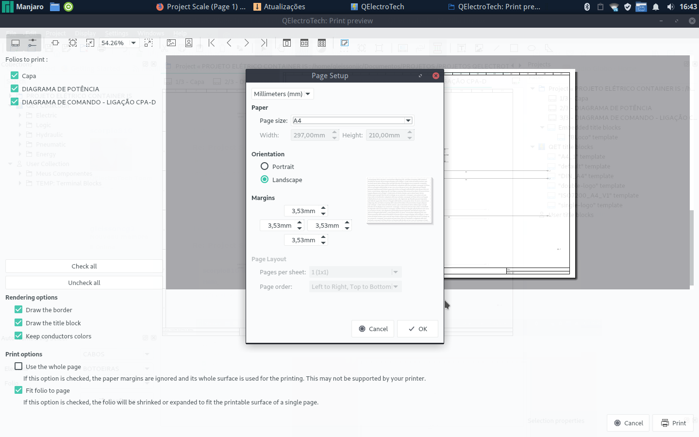

Good Morning ! They are doing an automation project, but when printing on A4 sheet, I think it's getting all small. Would there be any way to scale the drawing at the time of printing?
QElectroTech → EN : Help, suggestions, discussions, ... → Project Scale
Hello,
can you send a screen in print preview dialog?

Hi gleissoncg2,
in the print dialog, you have to make active the checkbox "Use the whole page".

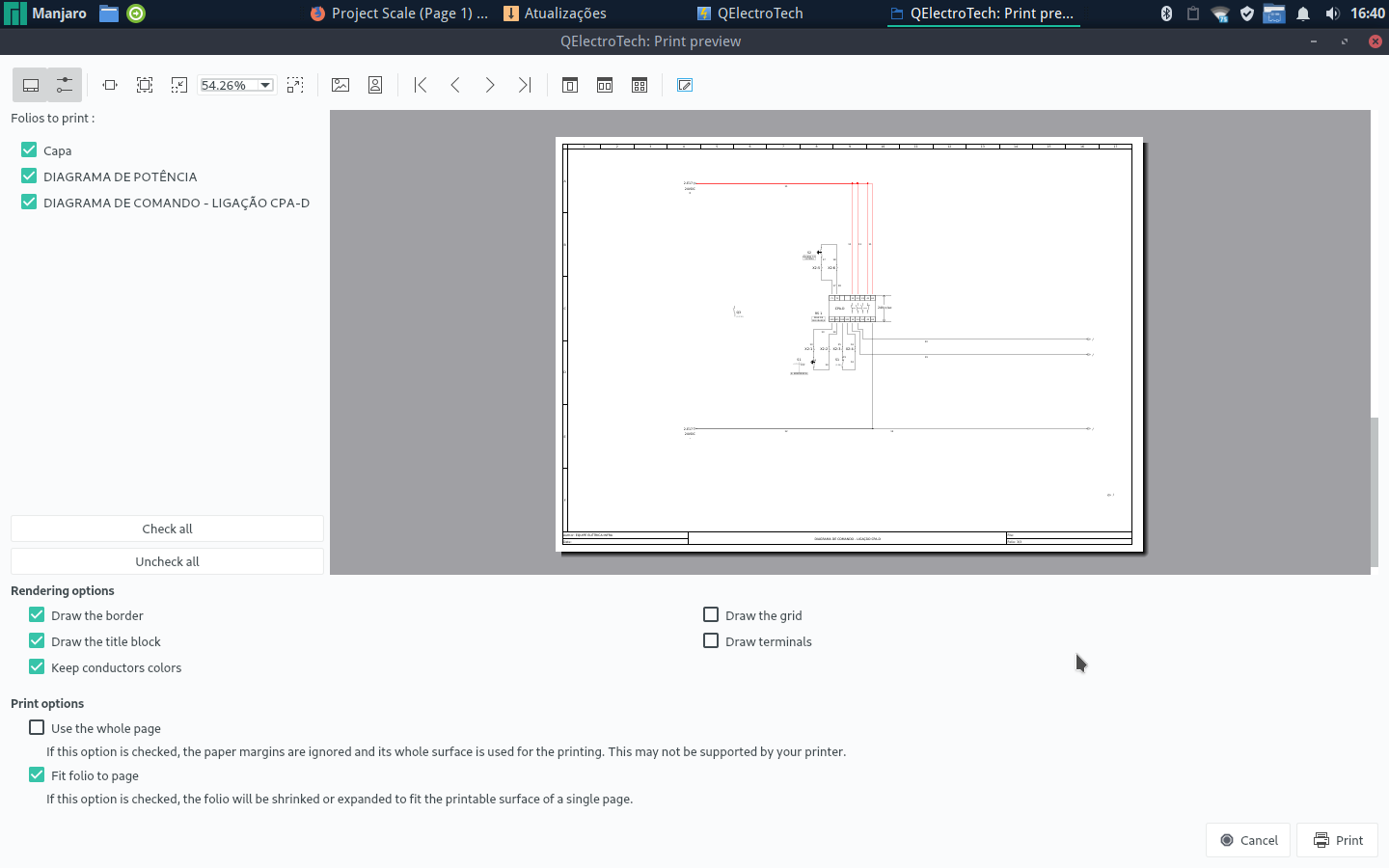

Hello ! I managed to get the result I wanted by making some adjustments in the columns and lines and also decreasing the pxs, which for some reason were very high. I recorded a video to demonstrate if someone else had it too.
Hi gleissoncg2,
I personnaly use:
columns = 8x148px
rows = 8x97px
it fits good on a printed A4 paper sheet or A4 pdf sheet.
Then, in the printing configuration, I use the following margins:
top:16mm
bottom: 8mm
right: 8mm
left: 8mm

When using 50px of 70px per column or row, the middle of the row is nicely centered on the grid. I didn't find an optimal number of columns to fit nicely on a A4 paper. It would be nice to have an option to be able to fix the middle of columns always on the grid. To make this possible the first and last column might be adjusted separately, with fixing the grid on the middle of the first column with the standard column width. Only the first and last column won't be on the grid.
I would like some other options here as well, like setting the starting column number (e.g. to 0) or to make the columns increasing over the pages (1-st page column 0-9, 2-nd page column 10-19 etc.)
For now I use the next settings to come close to A4:
Cols 21 x 50px
Rows 10 x 70px
