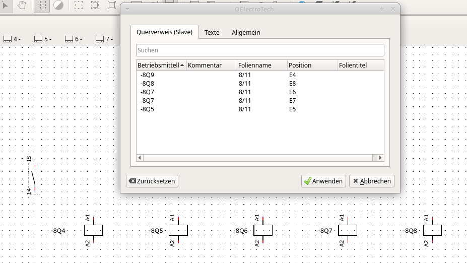

Hello,
label match not with property list from slave elements.
See pic.
Whats wrong?
QElectroTech V 0.70-dev+svn5396
QElectroTech → EN : Help, suggestions, discussions, ... → Cross reference label for master elements do not match(fixed)
Hello,
See pic.
Whats wrong?
Hello,
right click for submenu on item (view master, link, etc).
I can find the master, but the text does not match.

Hello,
i know how it works, to find the right master and how to connect them.
Thanks for help.
All i wanted to do, was ask what's going wrong.
Sorry for the bad question.

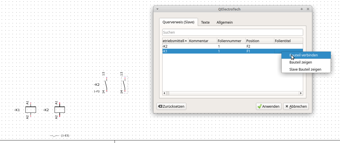

Hello Max,
i tried something and had something like in your picture. (desktop 1)
I have achieved this by input as in the picture desktop 2. Maybe you have any entries wrong.
Best regards
Stebo

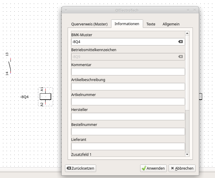

the second picture
I take a look and i have the same, in label is the wrong name.
I can delete the prefix pattern and delete the label and reset the prefix pattern.
But only the prefix letter is now in the list, without anything from pattern.
Revision: 5405
Author: blacksun
Date: 2018-06-21 17:36:03 +0200 (Thu, 21 Jun 2018)
Log Message:
minor fix : slave link dialog doesn't display the good label, when the label of master element is build from formula.
fixed, thanks for report
