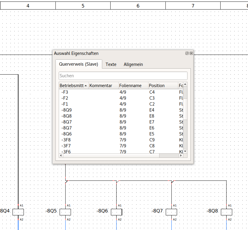

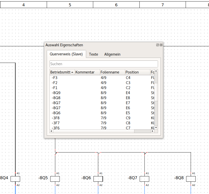

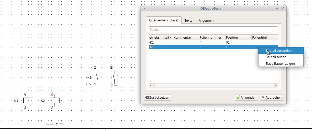

Hello,
label match not with property list from slave elements.
See pic.
Whats wrong?
QElectroTech V 0.70-dev+svn5396
Bildschirmfoto von »2018-06-19 18-31-35«.png, 57.35 kb, 832 x 771

Re: Cross reference label for master elements do not match(fixed)
I can find the master, but the text does not match.

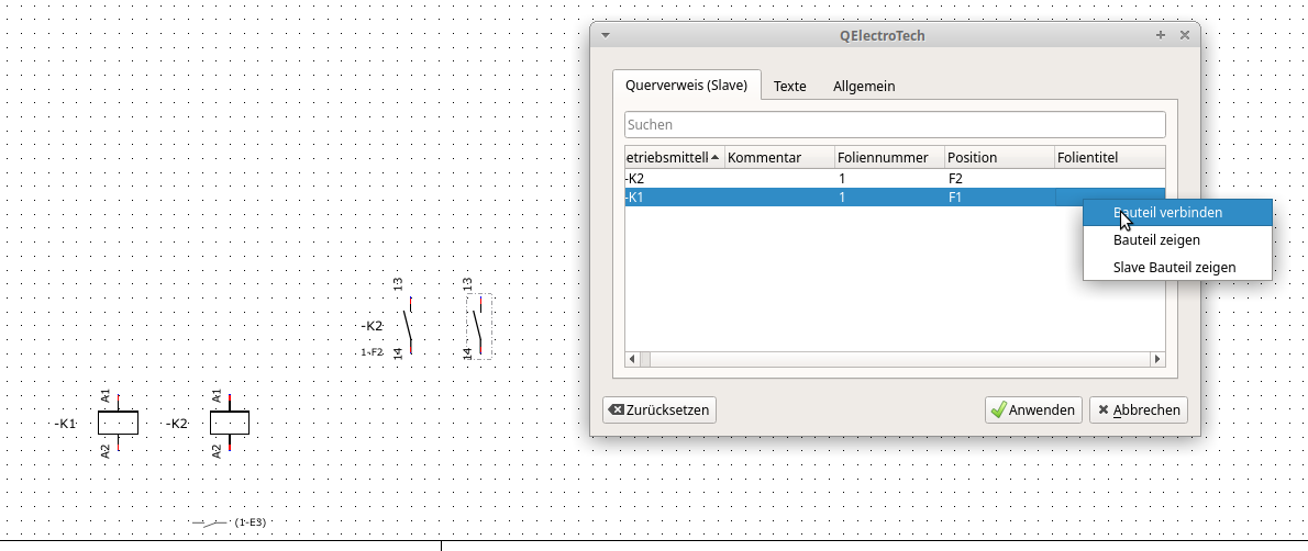

4 (edited by Calypso 2018-06-19 22:57:14)
Hello Max,
in the selection Properties menu, you select the master with the left mouse button, then you click with the right mouse button and go to connect with the left mouse button.
Best regards
Stebo
desktop.png, 42.49 kb, 1190 x 502
Hello,
i know how it works, to find the right master and how to connect them.
Thanks for help.
All i wanted to do, was ask what's going wrong.
Sorry for the bad question.

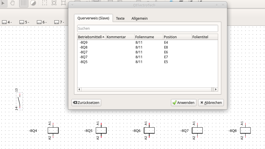

6 (edited by Calypso 2018-06-20 22:40:44)
Hello Max,
sorry, I think I missed something in your screenshot and did not understand your question correctly. How did you assign the equipment labels with automatic numbering? or did you enter the resource identifiers directly in the properties menu?
Best regards
Stebo

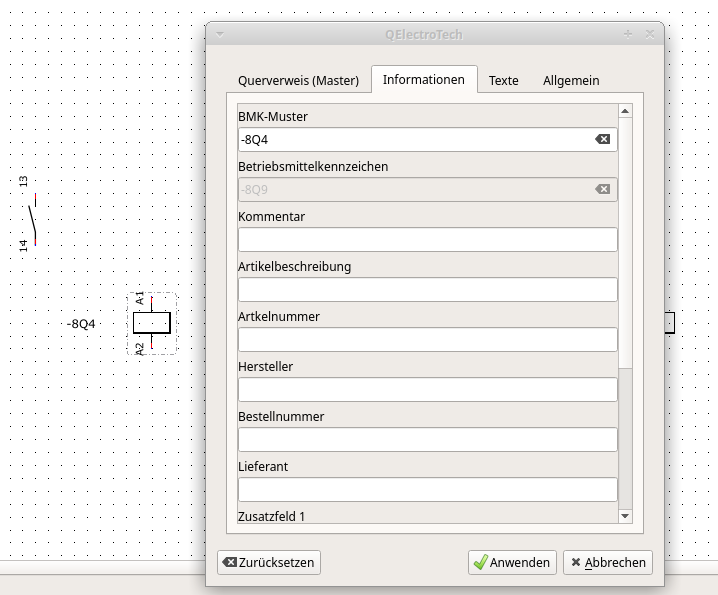

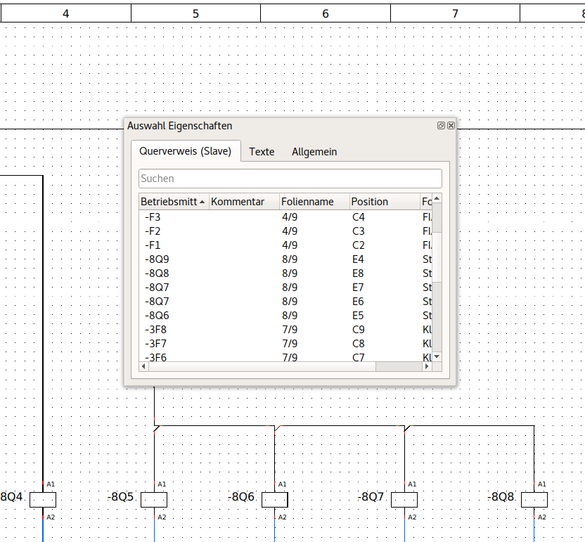

7 (edited by Calypso 2018-06-20 23:37:47)
Hello Max,
i tried something and had something like in your picture. (desktop 1)
I have achieved this by input as in the picture desktop 2. Maybe you have any entries wrong.
Best regards
Stebo

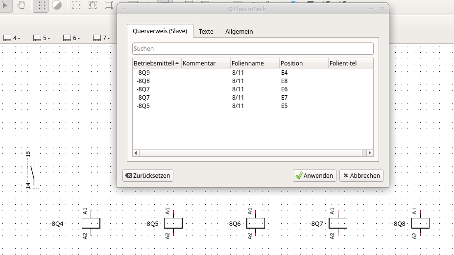

8 (edited by Calypso 2018-06-20 23:38:59)
the second picture
desktop 2.png, 40.72 kb, 718 x 595

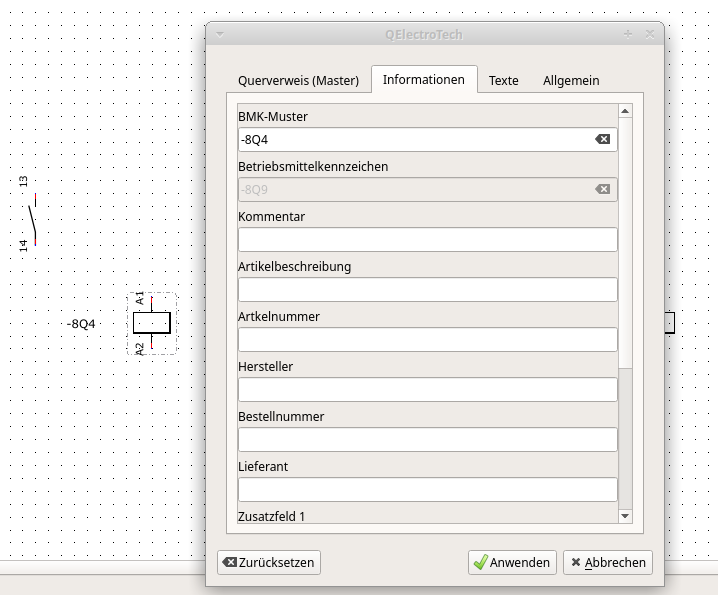

I take a look and i have the same, in label is the wrong name.
I can delete the prefix pattern and delete the label and reset the prefix pattern.
But only the prefix letter is now in the list, without anything from pattern.
Revision: 5405
Author: blacksun
Date: 2018-06-21 17:36:03 +0200 (Thu, 21 Jun 2018)
Log Message:
minor fix : slave link dialog doesn't display the good label, when the label of master element is build from formula.
fixed, thanks for report
