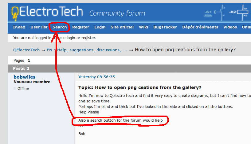

Also a search button for the forum would help

hi bobwiles
search-forum.png, 56.95 kb, 817 x 471

Thanks Nuri, So I'm blind and stupid,
