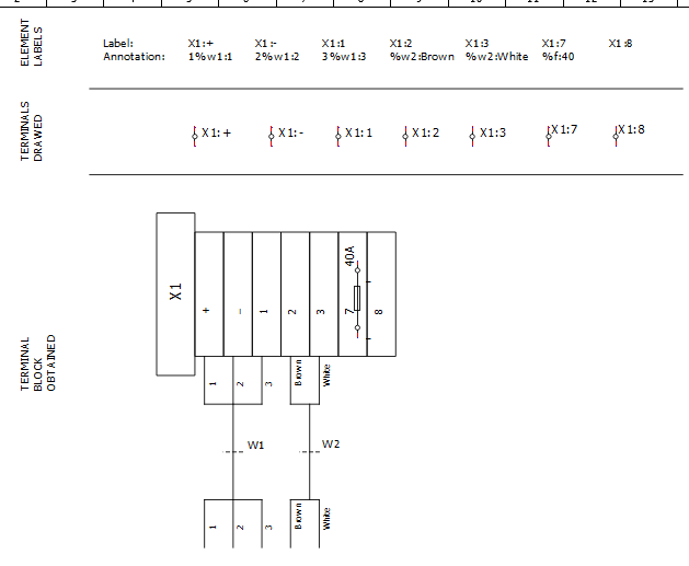

I'll update the code and I could add some new features. For example:
- Fuse terminals
- Auto-draw the cables connected to the terminal block. For example, if you have 5 terminals named:
  For every terminal you can specify in the "Annotation" label something like: #%w:#
   #  -->  order of the terminal in the terminal block. If doesn't exist, will be autoordered by the terminal name
   %w:# --> cable and conductor name.  Terminals with the same name will be draw consecutively
   %f:40  --> fuse type terminal.
Do you have more ideas?
sample.png, 12.3 kb, 629 x 517

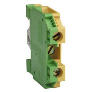

Yes, if you could add ground terminal. ;-)
https://www.materielelectrique.com/content/images_produits/schneider/H425578_web.jpg?v0.3.40
https://download.qelectrotech.org/qet/forum_img/terminal_ground.png

Hi Scorpio, I'm a PLC programmer and I work for a company. I'm not self-employed.
For the new version, maybe is better to dissable the option of searching for implicit connections (more than 2 connectors with the same name, implicates more than one terminal). I think is clearly to draw only the terminals that exists on the diagram.
Hi raul,
Ok, it's as you want, it would have been a pleasure to add you or your company as a sponsor.
And I think your work and pugin is used by your colleagues, or python programming is your passion?
