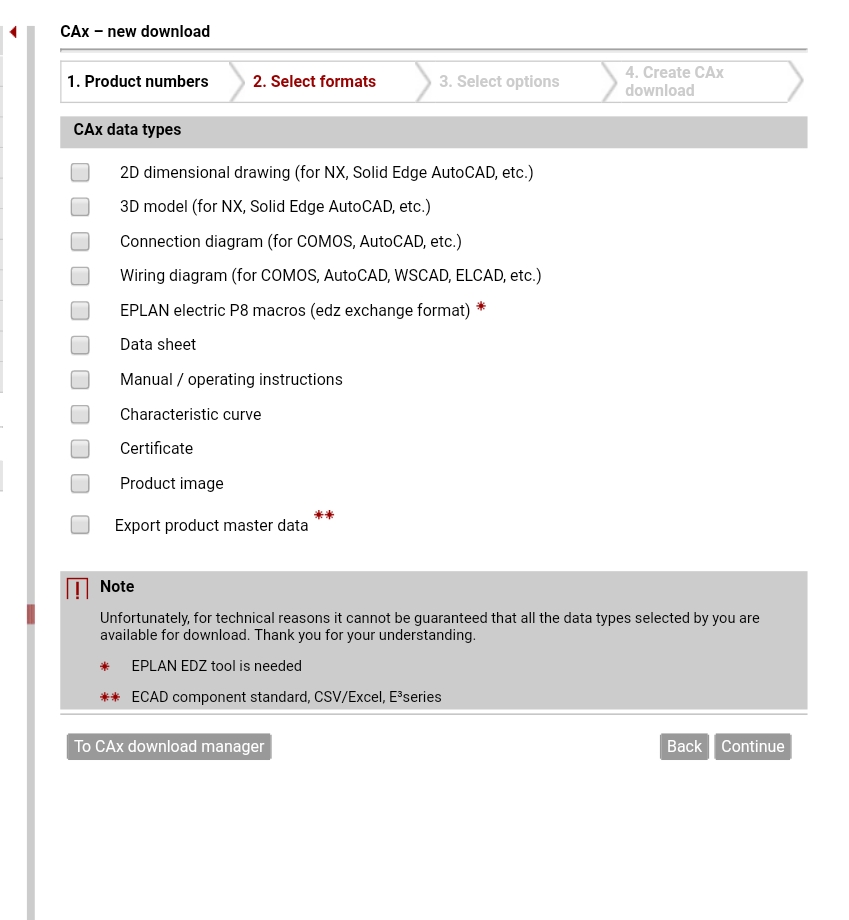

I work on Siemens components and I try download CAx data files from Siemens site and import data (dxf and csv).
But it's not possible.
On Siemens CAx portal aviliable many formats to electrical software.
I try import some files but not correct results.
Someone on community try make import from Siemens CAx site to elm?
CAx formats and a plan macros it's on many sites but would be perfect to import to Qelectrotech. Of course I know it's not simple.
And I have second question : someone have information maybe some databases symbols example from see electrical or others are compatibille to import to elmt?
Best regards and sorry for my English.
Screenshot_20171114-224617.jpg, 128.86 kb, 849 x 920

you need to choice 2D drawing or perhaps try wiring or connection diagram .. dwg format and convert to dxf ascii and after try dxftoelmt converter program.
