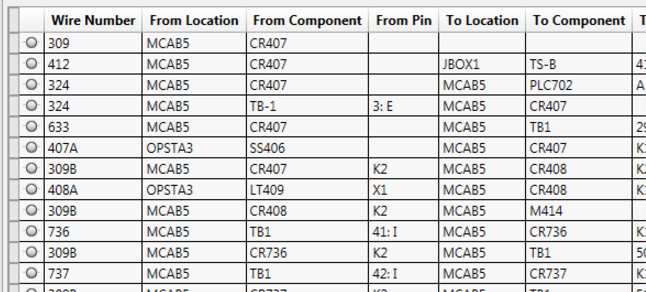

Will be well to do the same with cables, but maybe the best solution is to auto-create a "connections report table" of all conductors grouped by wires. What about doing something similar to the photo?
And generate the same table in element ? How over users represent wire ?
How you know wich conductor is in which wire ?
We could use , for example, the field "function" of conductor properties. If the field is blank or not in the format 'W1:1' the conductor is not part of a electric hose.
Tha table will show all conductors, and also the electric hoses. For every conductor of a electric hose, it will shows cable number of the hose and the cable number of the diagram, hose name,...
Draw elements is dificult for some reasons:
* if the terminal block is too long, it's splited in several elements and maybe the terminals for a one motor are in diferent QET Elements.
* The electrical hoses connects from the terminal block to a drive, switch, detector,... So I don't know what to draw at the end of the electric hose.
* A table allow you to have a cross-references to easy locate every cable from where to where. If you are fixing a machine and you know the number of a cable, seeing the table you know from where to where is connected, in what page appear,...
The photo shows a more real example:
connections_report.png, 47.35 kb, 804 x 306

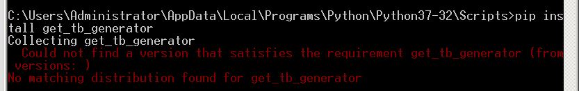

Welcome to All.
I try software and i think its the best !!!!
Congratulation to all comunity.
But i have problem with install tb generator.
Its no avliable to download package from python repository.
Can You help me to install this module  for cration TB?
generator.JPG, 29.44 kb, 833 x 132
