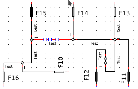

But depending on what conductor you edit, the T and X terminals fail;
T: The middle terminal is not updated when any other terminal is changed.
X: Depending on what terminal you change, one or two of the other terminals is not updated.
In the attached screen shot i set name on the selected conductor.  It propagates to some conductors but not to the conductors leading to F10, F11 nor F14.
Screenshot_Terminals.png, 12.57 kb, 460 x 297

Yes we know, only terminal with two connections work, terminal in T or X not report conductor properties in all connections.

(...and BTW it is the same when i make own terminal elements with more pins.)
Re: Terminals bug?
Yes we know, only terminal with two connections work, terminal in T or X not report conductor properties in all connections in automatic.
You need to enter manually conductor name forgotten in terminal T or X.
