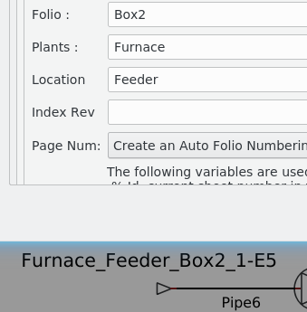

I played with the "Label of report folio" field and raised my hands in joy \o/ as it suddenly happened what i was about to ask for: I want the sheet referencing labels to show not only page number and coordinate, but also a short name of that part of equipment.
Just playing along for now, i entered %M_%LM_%F_%f-%l%c, and the result is as per screenshot below.
That is a bit overloaded, i probably only want to use Folio or Location ( plus _%f-%l%c ) in sheet referencing.

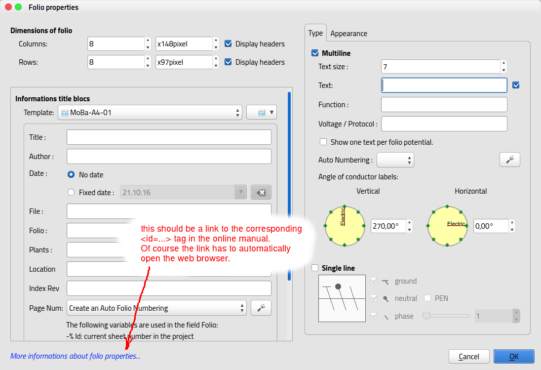

I think we need to integrate in the GUI some URL to the online manual to automatically open in a web browser.
Heuu ... is already in about menu, or just enter F1 key for open web browser to online manual.
OK is only open English manual now, but russian guys can change URL for russian translation.
https://download.qelectrotech.org/qet/j … ET_ru.html
It would be the easiest way to keep informations up to date. But the online manual must be written by some people how can correctly write in english...
I see there are already short explanations here and there where variables can be defined and used.
IMO, you should keep those short explanations there, (make sure they are complete and correct, but short) and every such place link to a chapter that carries full information; beginning by why, concept, how to use by simple example, then a table(?) listing all variables and where they can be set, then listing or explaining where they can be used.  And some syntactic how they can be combined, what characters are legal, etc.
It would be good if manual could be installed locally, by distro package or manually downloaded and uncompressed some specific place that works with those links.  Not everybody have internet access always.
I know, I know...nomicons/wink
I mean something like that (see screenshot).
Of course it only makes sense when the online manual is complete.
