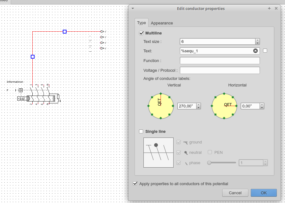

I have a question to the circuit numbering. Have used it for orientation to join references. Now if I want to connect a link to another page in the version 0.51.r4720 me appears only% sequ_1.
I connect a reference to a conductor on another side of the conductor numbering remain different, is that right?

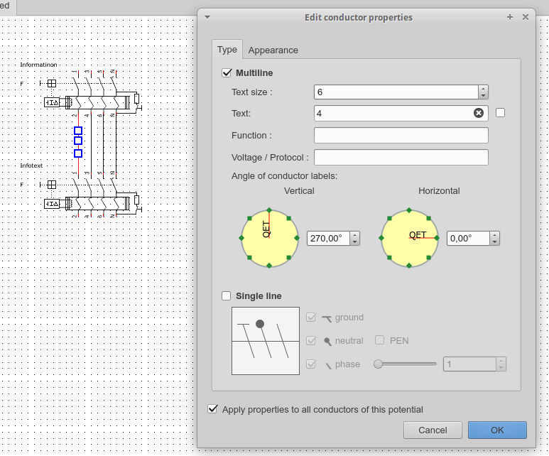

have two screenshots I hope you can see what I mean. My English is not good

here the second screenshot

In Autonum selection choose an empty rule.
