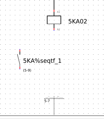

Problème:
lorsqu'on créé des bobines avec une règle, quand on lie un contact le nom du contact ne prend pas correctement le label de la bobine

Re: Folios non consecutive numbering, new dock collection element (EN)
galexis wrote:
Problème:
Thanks for reporting this galexis. Bug is now corrected nomicons/smile

3.
If I want to edit some conductor properties, the tab "Appearence" is always shown by default. It is not convenient because, in the most cases, the user wants to edit the properties of the tab "Type" rather than those of "Appearence".
Revision: 4610
Author:   scorpio810
Date:     2016-08-08 11:32:56 +0200 (Mon, 08 Aug 2016)
Log Message:
Minor : Conductor properties restore tab priority to tab "Type"
Nuri wrote:
1.
While I'm edting an editable text field of an element placed in the diagram editor, if I use the key "Home" or "End", QET does not move the cursor to the beginning or to the end of the text field but show the first or the last folio of the project. Is it possible to make an exception to use the keys "Home" and "End" in a text field?
2.
If I select an element in the diagram editor and then use the directional keys, they move the element. Right. But if I select several elements, QET move the view of the diagram and not the elements anymore. Is it possible that the directional keys only move the view while no elements are selected?
Revision: 4613
Author:   dfochi
Date:     2016-08-08 13:42:47 -0300 (Seg, 08 Ago 2016)
Log Message:
Fix Home and End Buttons Handling and DiagramEditor Scroll
Hi Nuri, I fixed issue 1. Issue 2 I couldn't replicate it as you described it but I found a bug related to text items. See if it corrected your issue as well.
Hi Davi, yes you're right, it's a little bit more complicated I believed first.
I can not replicate issue 2 everytime. Sometimes only the up key does not work. Maybe is the issue related to the zoom factor, I don't know.
But for sure I can not move basic shapes and text fields (those from the upper tools bar) with the arrow keys.
Basic shapes are definitely facing some bugs with arrow keys. This last commit that I uploaded solved the problem for textfield but not for the other shapes. I will work on a fix for it.
