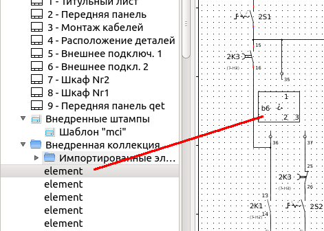

Topic: Missing element
I did not notice with what version of the update is displayed, but the project were created elements propodaet me. And not every project. Some projects have disappeared, others remained. And no matter how much the old project. Unfortunately I did not make the user library. And in vain! Now I do. Unfortunately it is impossible to remove from the draft the missing elements in the draft elements of the menu. But interestingly, if the "element" of the scheme selected for editing, then everything is fine. You can even try to save, but in the project, he still does not appear.

Hi Aleksandr,
Could you post some screenshots describing more accurately your problem?

Re: Missing element
Hi Aleksandr,
i think we have a little bug on latest devel packages.
If i open oldest project i see a few elements are lost.

Re: Missing element
I love Linux,  for the fact that you can open a terminal. Yes, indeed, the missing components from the library. Below is a small part of all messages.
The element :  "/home/aleksandr/.qet/elements/anly503.elmt" haven't got an uuid, please edit and save this element with element editor to create an uuid
The element :  "/home/aleksandr/.qet/elements/centrifugal_contact.elmt" haven't got an uuid, please edit and save this element with element editor to create an uuid
element error.png, 44.9 kb, 471 x 336
Re: Missing element
Only question. How do uuid?
Re: Missing element
It's not very serious, the program will generate provisionally for each launch Qet.
For one or two elements just edit these elements and save.

Re: Missing element
Thank you. We will try to recover!
Re: Missing element
It's solved for embedded element collection.
Thank you for reporting this bug.
Revision: 4420
Author:   blacksun
Date:     2016-04-03 19:01:44 +0200 (Sun, 03 Apr 2016)
Log Message:
Fix regression with embedded element collection
