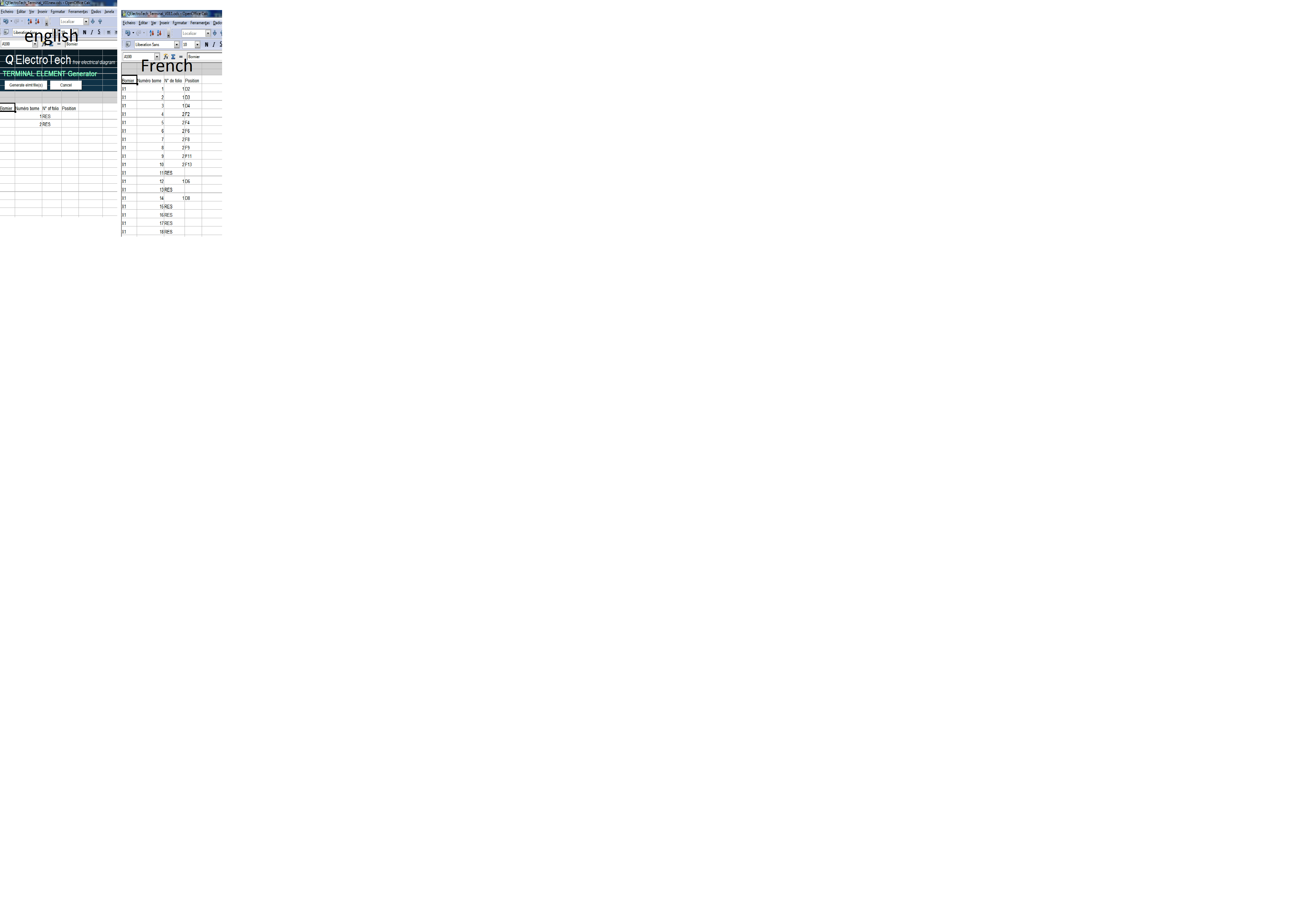

Yes, i talk terminal macro.
i send picture in English and French.
I think the problem is in this line of macro.
MotFiltrage = CurrentSheet.getCellByPosition(1, i+8).String
i I changed the line to:
MotFiltrage = "Terminal Block"
so works in English, the problem is to change the language of qelectrotech will not operate.

I found the problem.
I have to change the search word in the configuration page.
Thank you for your support
Re: New floating dock is now ready, news colors, patterns, etc.
Is easy to change language : go to settings menu -> Configure QElectroTech and choose your language you want.
Reboot Qet to apply the change, load your project and now export a new nomenclature, or just refresh element collection by touch F5 and now export a new nomenclature.
The nomenclature "csv" is now in french and run well with LO macro.
