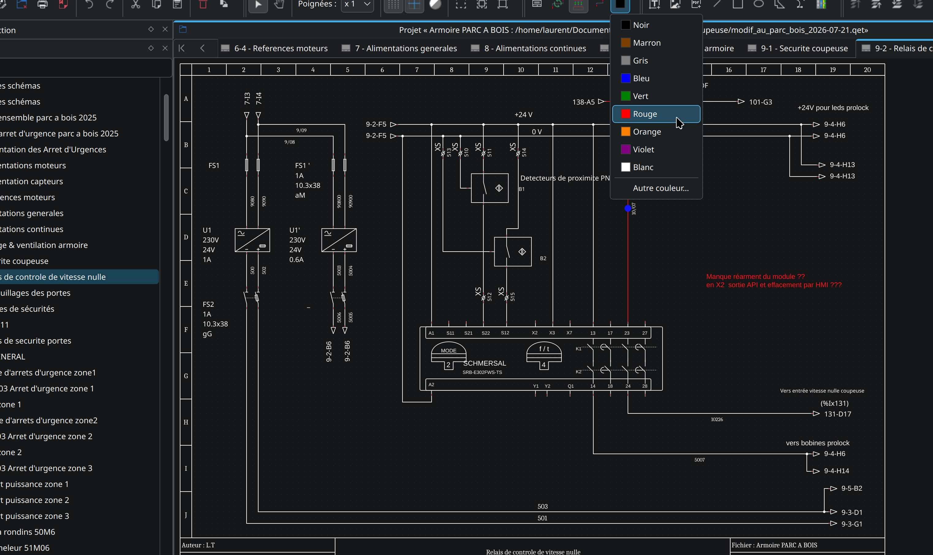

Yesterday, as part of a major retrofit of an old installation machinery, I was able to test PDF files exported from QET (Qt6 MSI installer) with page references, XREFs links on a very, very old PC running Windows 98 SE to April 5000/Orphée, equipped with Acrobat Reader 5.0. The software opened them without any problems and the page references and XREFs links worked perfectly – brilliant! This will make troubleshooting much easier, with the PLC programme in one window and the drawings in another. just need to change old vintage 14" crt monitor to an new lcd monitor..19"..
And I no longer need to carry my QET laptop around with me everywhere, even though the Ctrl + F shortcut is more convenient than the PDF search function for carrying out in-depth searches within a large QET's project.
I don't want to brick it this nice feature..in older system..

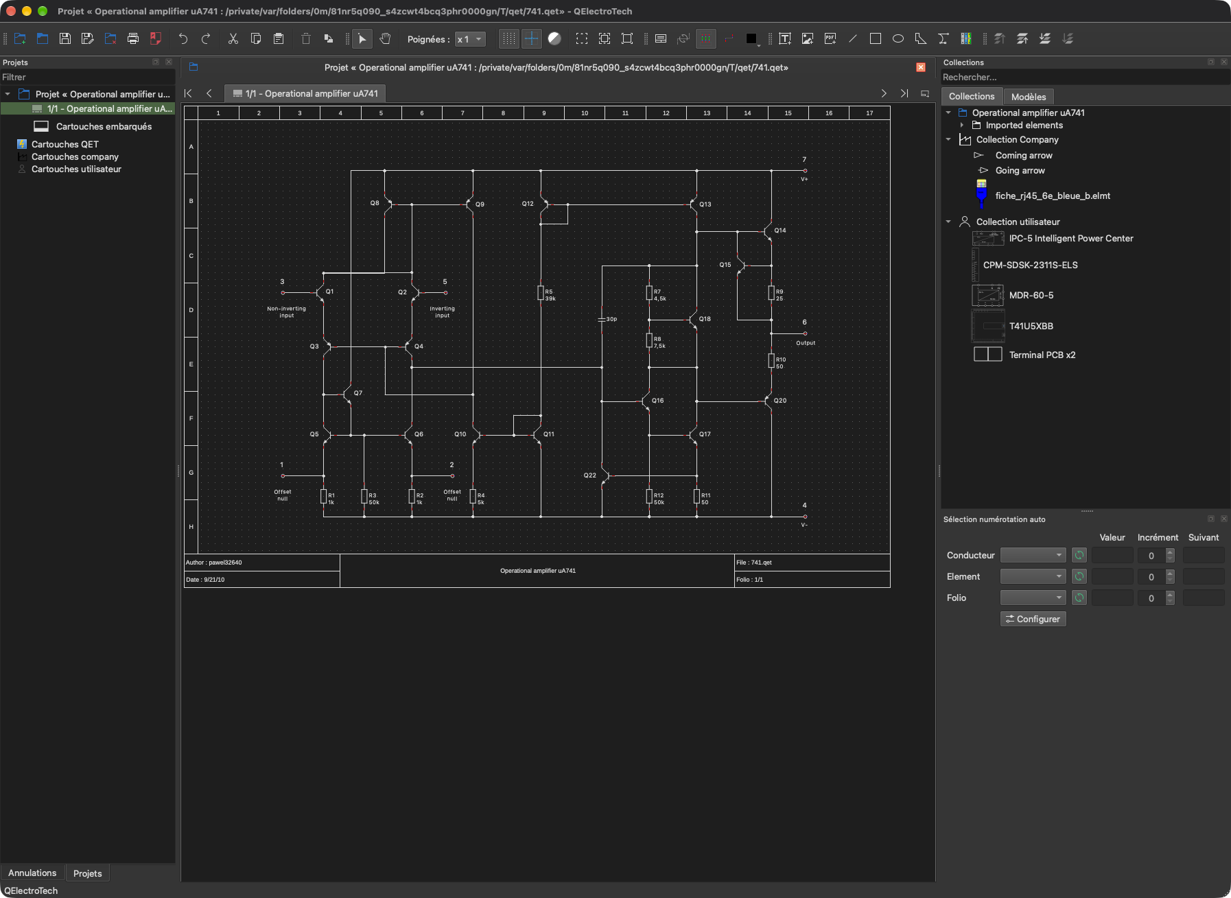

FYI, macOS Apple Silicon arm64, signed and notarized it's now on Qt6 + KF6 frameworks ports.
Enjoy!
