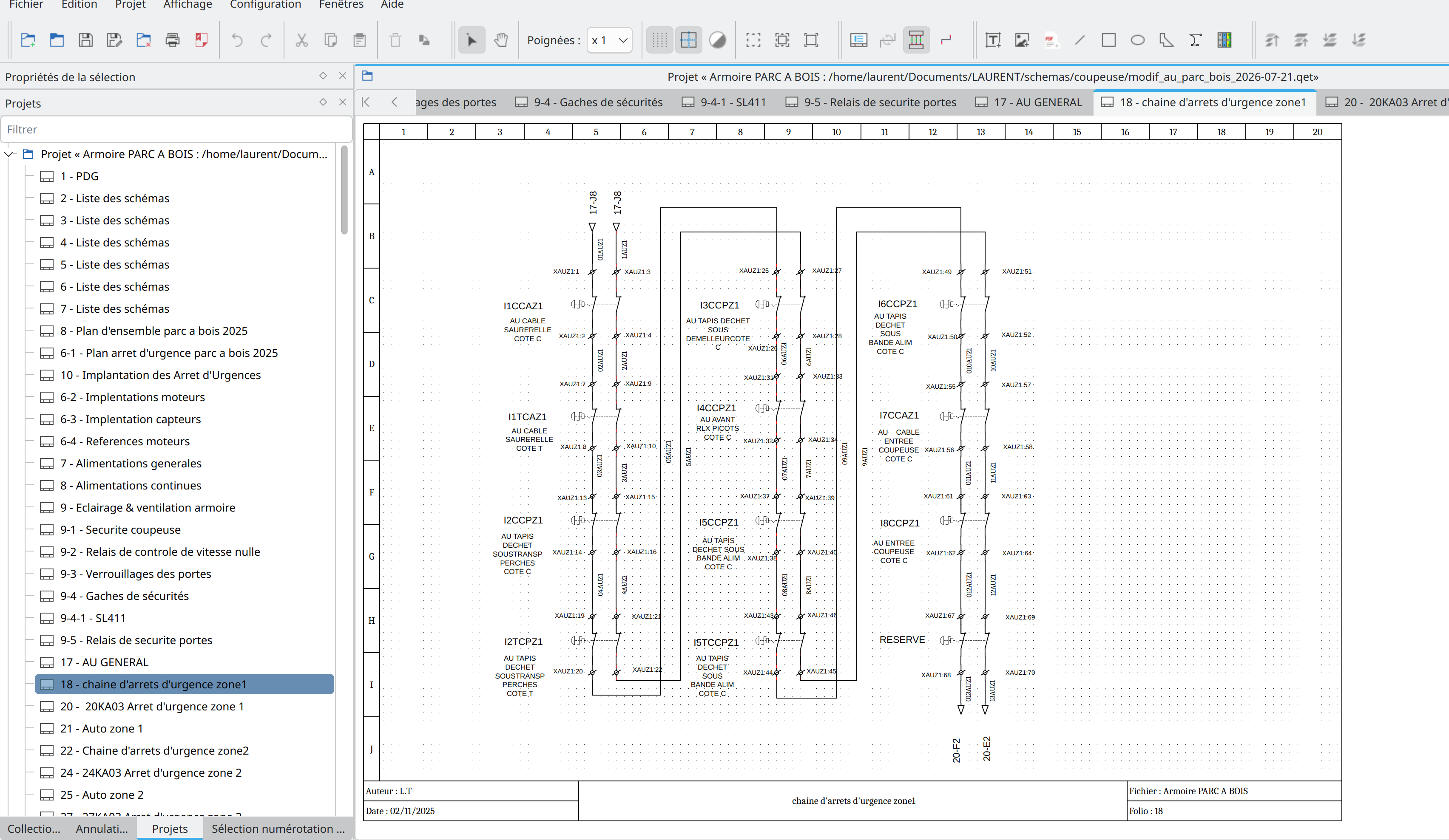

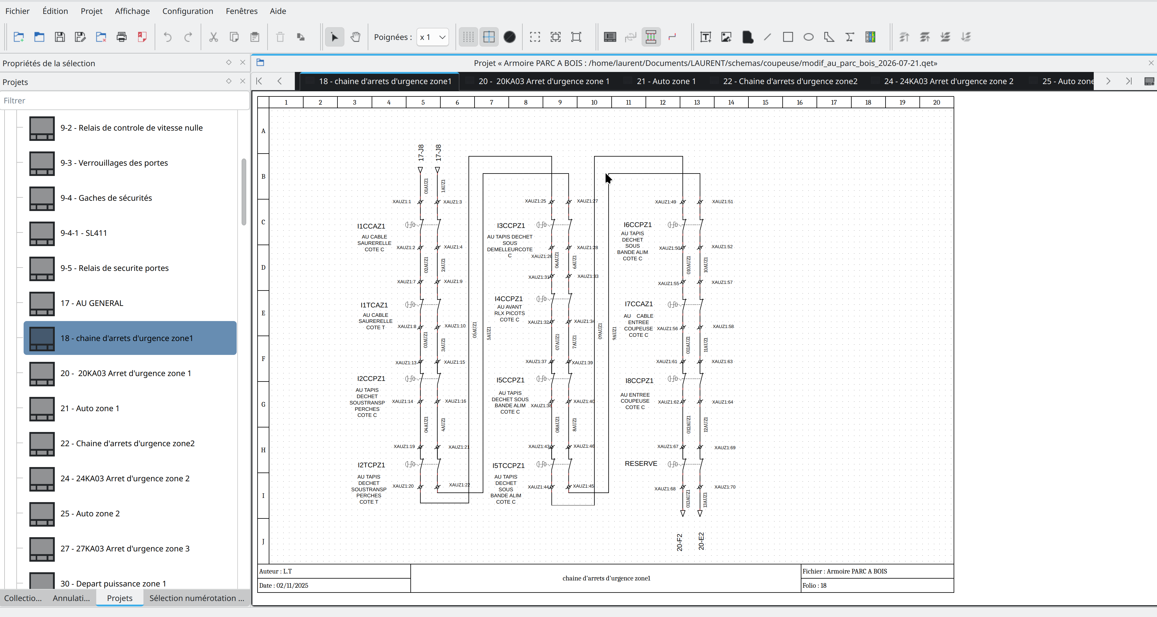

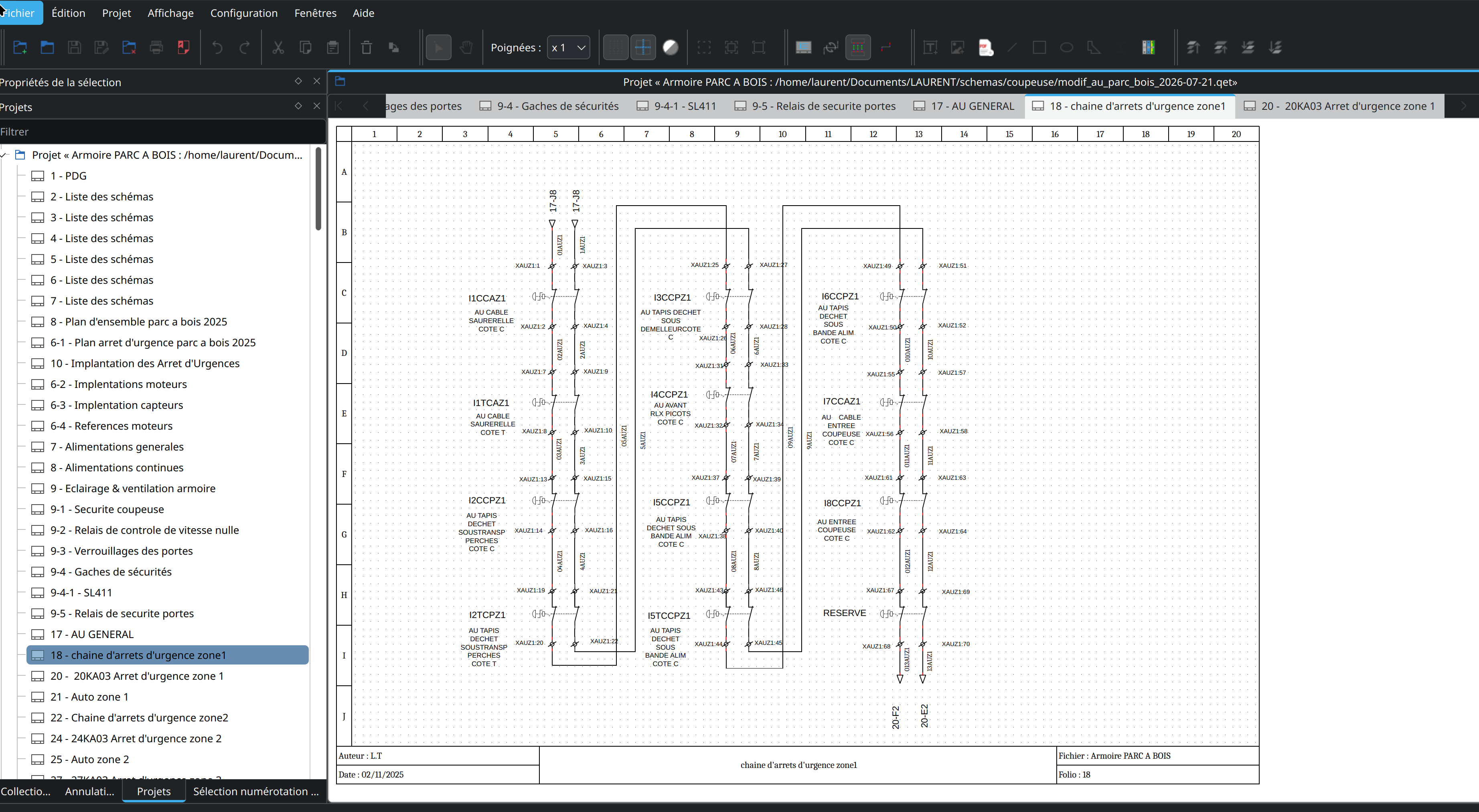

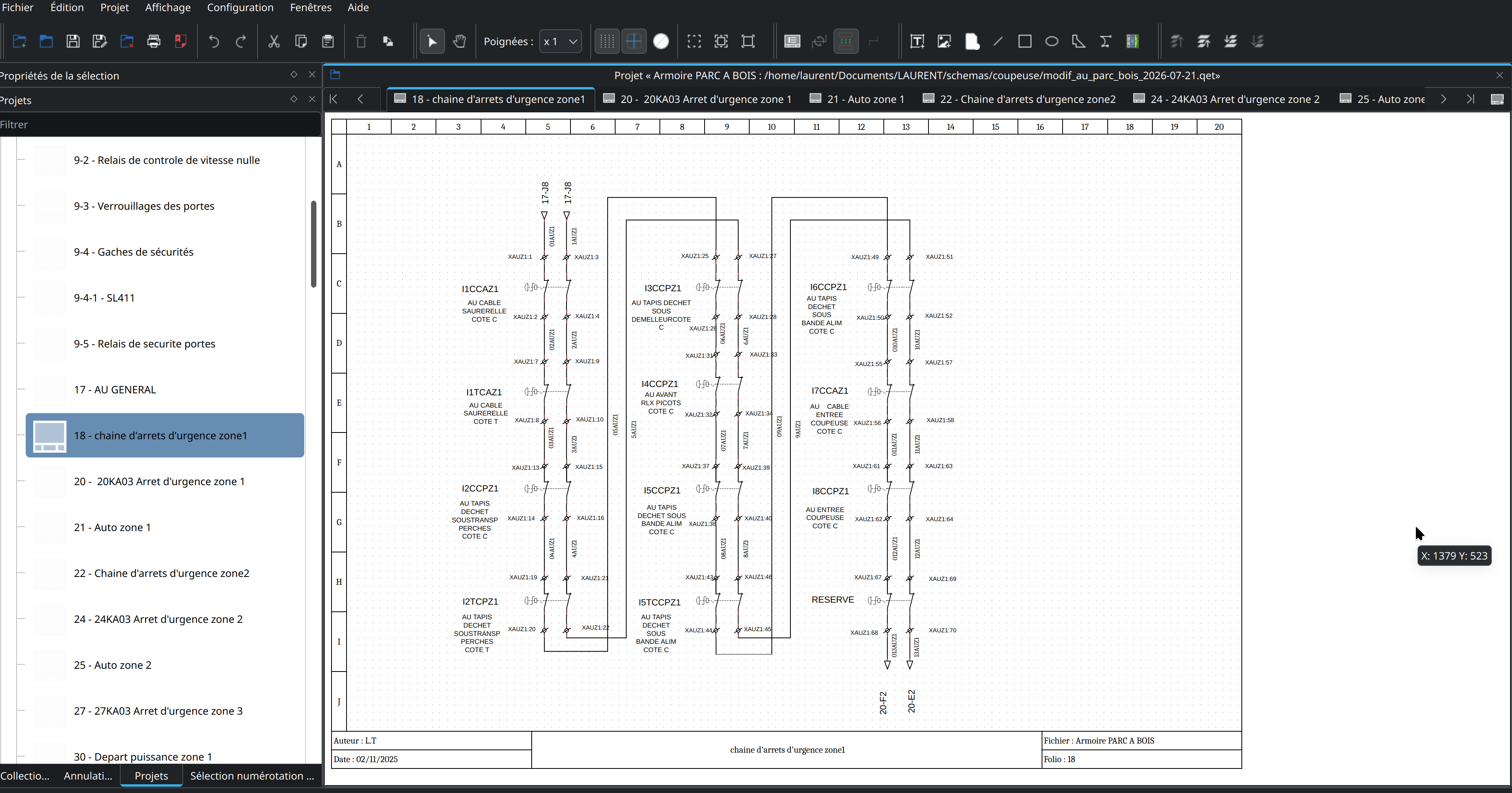

FYI, jp2images working on dark theme, not commited yet.
https://github.com/qelectrotech/qelectr … a6b7275d30
I'm tried on my Debian unstable with KDE plasma6.
dark_master
https://download.qelectrotech.org/qet/forum_img_2/dark_master.png
dark_jpp2images
https://download.qelectrotech.org/qet/forum_img_2/dark_jpp2images.png
light_master
https://download.qelectrotech.org/qet/forum_img_2/light_master.png
light_jpp2images
https://download.qelectrotech.org/qet/forum_img_2/light_jpp2images.png
