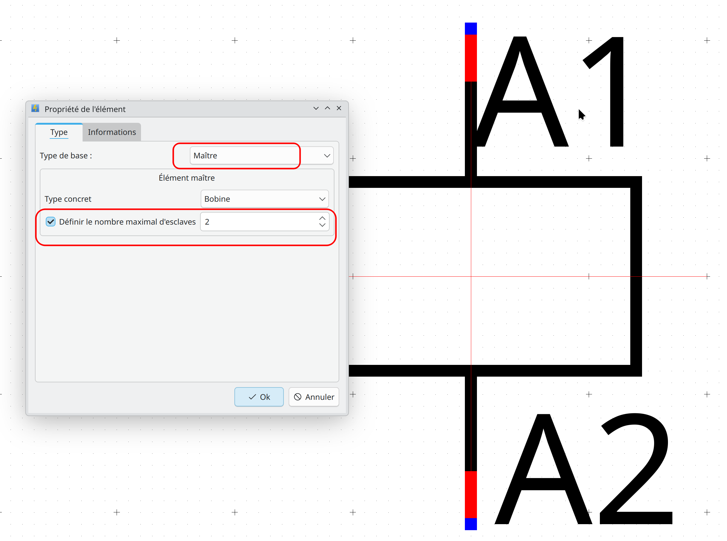

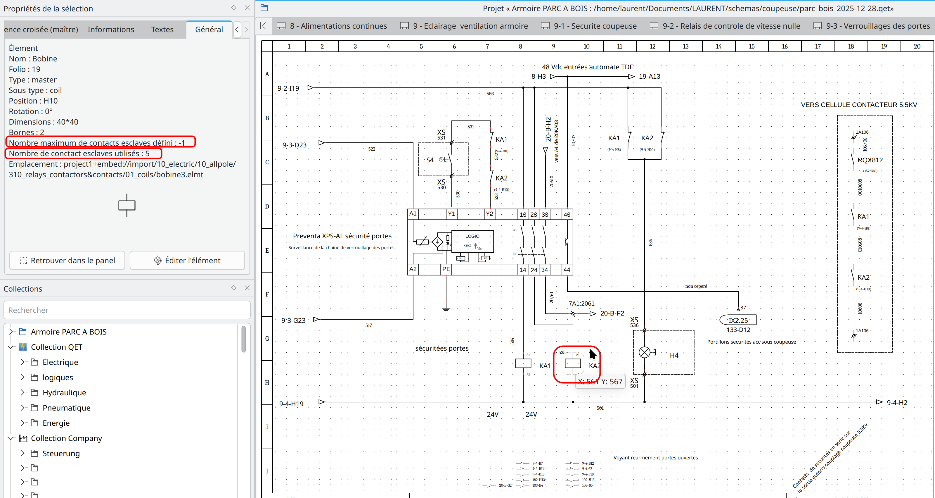

Re: Anzahl Slaveelemnte definieren / Define number of slave elements
https://download.qelectrotech.org/qet/forum_img_2/max_slave_contacts.png
https://download.qelectrotech.org/qet/forum_img_2/general_element_info_widget.png
