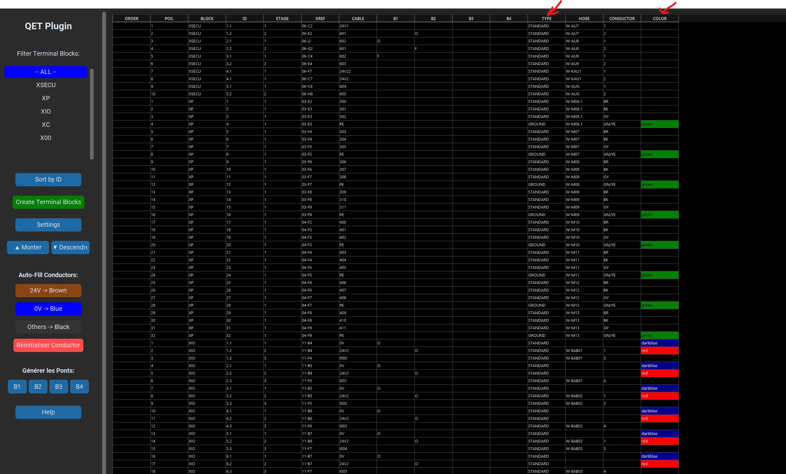

updated on pip today, to replace object position problem with tkinter with long terminal list
now work with tksheet for best response and long terminal list
can be launch from qet or as standalone executable downloadable in release
https://github.com/XavierDeven/qet_tb_g … /tree/main
you can click on header type to set ground automatically if cable is names pe
and you can also click on color header column to set blue red green if cable is contain 0V, 24V, 48V OR PE

I have discovered two problems with Terminal Generator v2.1.4 (Custom Tkinter), the first is also present in version 1.
I use "Linux Mint Debian Edition" with Linux kernel "6.12.85+deb13-amd64" and "Cinnamon 6.6.7".
1 - The plugin does not consider the setting Settings -> "Configure QElectroTech" -> Project -> "Number the title block column from 0 (1 otherwise)"
When the setting is checked, all the references generated by the pluging are displaced by +1 .
If for example a terminal is placed in 1-D4 it will be shown in the generated block as 1-D5
2 - The second problem is related to the Settings page of the plug-in. When I click the button Settings I get an empty window.
Thank you very much to all the QElectrTech team and contributors, and thank in advance if somebody can help me on those issues :-)
