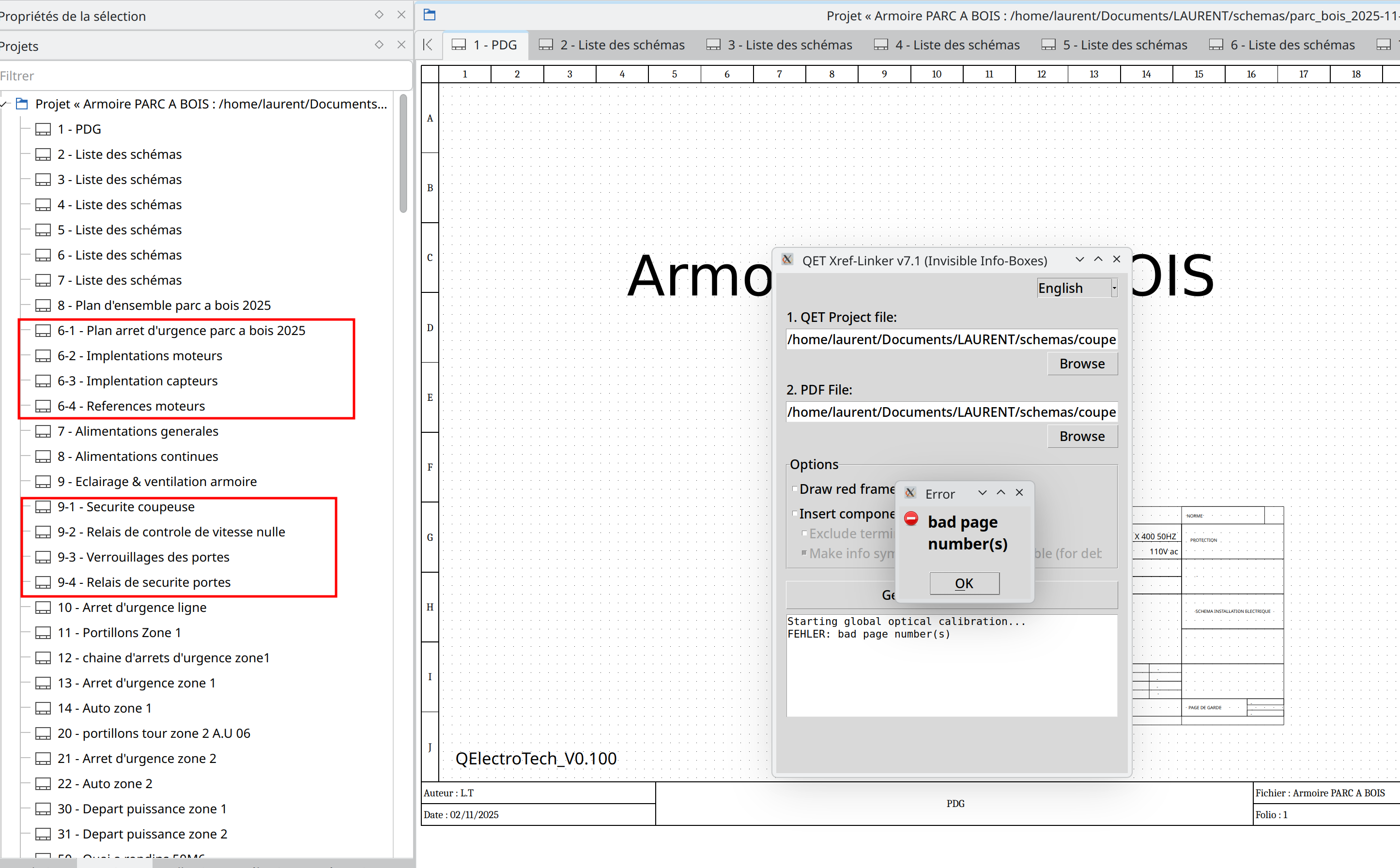

Re: Python script for generate cross-references in .pdf file
WOW, great work Thomas, but for the latest documentation of a project I'm currently working on with very customised folio orders, the programme you wrote crashes. I suspected as much beforehand, but for other less exotic projects, the programme works very well.
https://download.qelectrotech.org/qet/forum_img_2/Thomas_qet_linker.py_crashe_with%20personal%20page_numbering.png
45 (edited by Kellermorph 2026-02-27 14:13:41)
Thanks for testing and reporting back. I'll look into where the problem lies, fix it, and upload an update.
would it be possible, that u give me .qet to test it? I have tried with a single page with 2-1 and it works.
