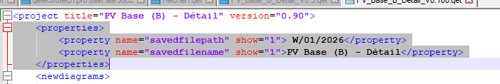

Re: Impossible d'ouvrir un fichier qet
The XML in your project file is corrupted.
Something went wrong with the project properties.
Open the project file in a text editor and adjust the file accordingly,
as shown in the image.
Then you should be able to open the project again.
projekt-XML.png, 15.28 kb, 701 x 118

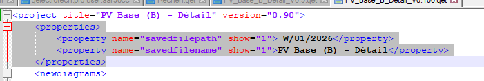

You can use QET_ElementScaler to check, if the file contains valid XML!
See also this post: https://qelectrotech.org/forum/viewtopi … 819#p20819
In this case the output of QET_ElementScaler is this:
$ QET_ElementScaler PV_Base_B_Detail_V0.9.qet
File "PV_Base_B_Detail_V0.9.qet" could not be loaded: Start-end tags mismatch
Check file up to byte-offset: 91 -- content partly shown here:
(...)l" version="0.90">
    <properties>
        W-01-2026</property>
        <property name="savedfilepath" show="(...)
As Achim already said, you can/should use a text-editor to fix the erratic tags.
