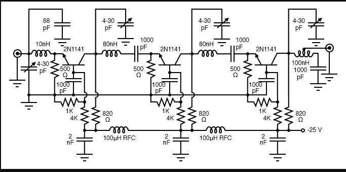

Is QElectroTech the right program for drawing electronic circuit schematics, such as the one attached?
Or should I learn how to use something like KiCad instead?
Thanks!
Screenshot from 2025-12-21 10-24-21.png, 77.03 kb, 683 x 339

You can draw such plans with QET, but there is NO WAY to get a printed circuit from a QET-diagram!
Learn to use KiCad  ...  that software is made for electronic circuits and not very hard to use! nomicons/smile
