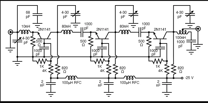

Is QElectroTech the right program for drawing electronic circuit schematics, such as the one attached?
Or should I learn how to use something like KiCad instead?
Thanks!

You can draw such plans with QET, but there is NO WAY to get a printed circuit from a QET-diagram!
Learn to use KiCad ... that software is made for electronic circuits and not very hard to use!
