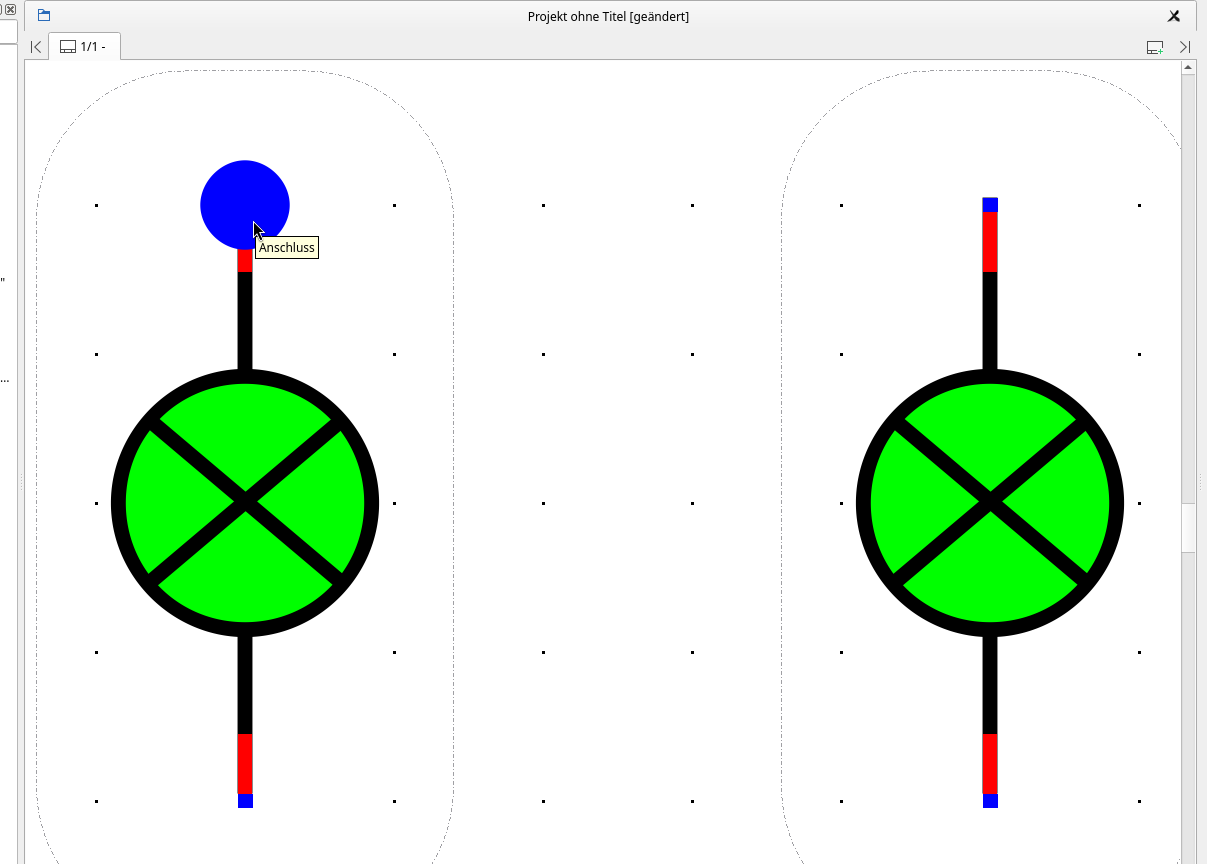

Do your elements have terminals?
(recognizable by the blue-red coloring – see screenshot)
Then you can draw a connection from one such connection to another.
Afterwards you can double-click the connection to enter the potential, line type, etc.
In the screenshot the view is "slightly" zoomed to two lamps and the mouse-pointer is hovering over a terminal. When the end of a terminal changes to a blue circle, you can click and drag to another terminal.
