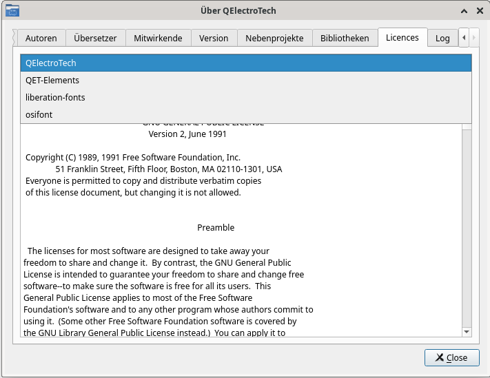

I have already adjusted the tabs for the licenses locally: All licenses are grouped in one tab and can be selected for viewing via ComboBox.
But that only makes sense to upload once the fonts are available.
And the customized element collection is also waiting to be activated: Only the fonts are missing...
