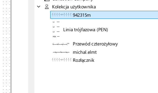

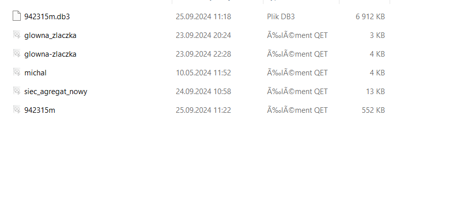

I have a problem with converting DXF file to QET. I'm using "DXFtoQET" for converting DXF file, everything looks good, so program create for me the file in my depository C...get/elements (see photo1). Furthermore, I have also seen this in QET on my “user collections” (see photo2). Unfortunately, I can't use this in the program, could somebody follow me what I'm doing wrong ??

What do you mean with "can't use it"?
An element with the name 942315m is in the user-collection.
So just pull it onto the schematic!
Can you open the element in Element-Editor by double-clicking?
Then save it before trying to use it in Circuit-Editor.
Maybe the use of dxf2elmt results in a better element?
Give it a try...
