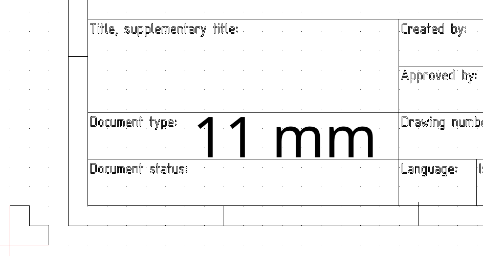

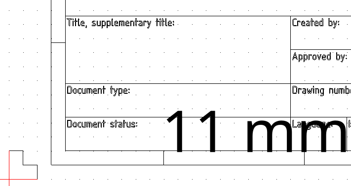

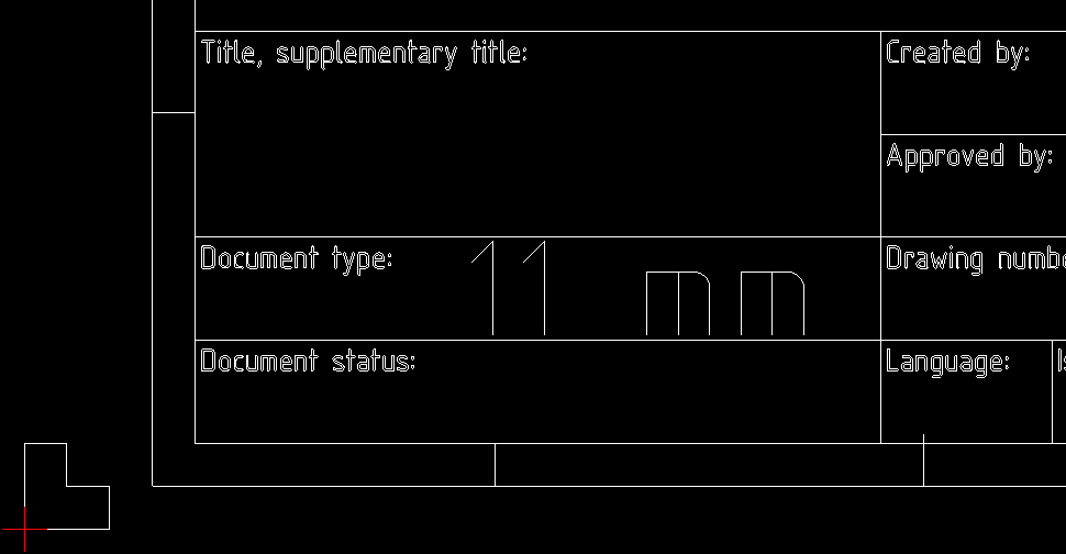

Just to understand you correctly:
You think the calculation of the text size is correct if a text that fits well into a rectangle in the DXF is much bigger and no longer fits into the same rectangle in the converted element? And that's because it says somewhere that a px is not as big as a pt? Seriously?
Attached is another example to clarify what I mean:
A DXF file in which I have inserted an 11 mm high text into a field of about 12 mm. Next to it is the converted element file, where you can see that the text “11 mm” definitely does not fit into the same field. In addition, the element file in which I changed the text “11 mm” to the appropriate size “22” and moved it.
I am explicitly not talking about the text position here, as we both know that this does not yet fit: I'm talking about the text size!
Note:
I used dxf2elmt - sources from last weeks commit c3a5b2a.
Attachment icon Bildschirmfoto_20250129_001_LibreCAD.png 6.68 kb, 78 downloads since 2025-01-29
Attachment icon Bildschirmfoto_20250129_002_converted_by_dxf2elmt.png 9.24 kb, 65 downloads since 2025-01-29
Attachment icon Bildschirmfoto_20250129_003_Textsize_and_Posittion_corrected.png 11.03 kb, 77 downloads since 2025-01-29
Re: New .dxf to .elmt Conversion Program
Hallo plc-user
I think I worded things in a way that did not translate properly for someone who is not a native English speaker. Sorry about that, I will try and word things better to make it more clear.
The current code is my first attempt and properly handling the text sizing, and text scaling over what Antonio had with just a fixed 12pt font. I based the conversion of the text size from real world units (which the text height is stored as in dxf) to font points using the defined definition of 1pt = 1/72 inch. In the couple of drawings I tested this scaling looked OK, but I knew it needed more testing and verification. I checked it in because it was already better than what was there. Perhaps I need to do a better job and work at some of these features in branches instead of on master so people don't think the checked in code is fully functional, however you testing against it and provided these files is very useful feedback for me to fix problems.
When you brought this up and provided the Schriftgroessen file I checked against some online calculators converting mm to pt to verify that I had done the math correctly in my code. Based on the conversion of 1pt = 1/72 inch, I did do the match correctly in my code, but this conversion factor clearly does not provide good results, after testing against some more files.
So the question is what conversion factor do I need to use? In the Schriftgoessen file you provided, if I had assumed that 1mm  = 1pt and then scaled it with the mm->px conversion of 2x, that actually would have been more accurate. It looks like it actually should be converted by a factor of 2.1, but 2 would have been closer than 2.8 used based on the mm->pt conversion I used. What I need to figure out is that roughly 2x height to pt conversion in the Schriftgroessen file something that could be valid or just coincidence in the factors similar?
Perhaps a better method here is assume that 1 unit (based on the file, mm, inches etc) is equal to 1pt and then scale based on the 1mm = 2px, perhaps I should always assume 1mm = 1pt, and then scale. I'm not really sure, I'll need to do more testing to try and narrow down what the right scaling factor might be, and need to make sure I'm testing against multiple units.
I think the next step for me to do is create a handful of files along the lines of Schriftgroessen but in several units like inches, ft, cm, etc and do some testing to try and narrow down a more accurate scaling factor.
Hopefully that makes things a bit more clear.
Hello vadoola,

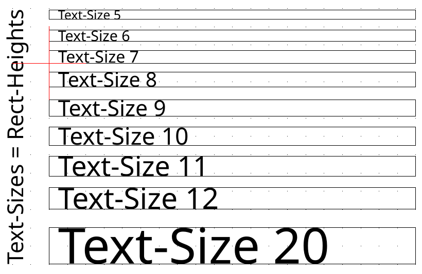

let's put it this way:
I created a QET-Element just with the use of element-editor.
In the attachment you see, that the texts are the same size as the height of the rectangles.
So in my opinion we do not have to use another factor than 2.0 for the "real world" size in the DXF!
When DXF says circle has a diameter of 10mm then in element it is 20.
If it says 1 inch in the DXF it will be 50.8 in the element whether it is a graphical part or a text!
It does not matter if text or anything else: There is always a "scale" of 1mm = 2px
I checked in all DXFs I have: Fits everywhere!
If you have a DXF where the factor of 2.0 does not fit: Let me see.
Attachment icon Bildschirmfoto_2025-01-29_textsizes_in_QET.png 54.08 kb, 76 downloads since 2025-01-29

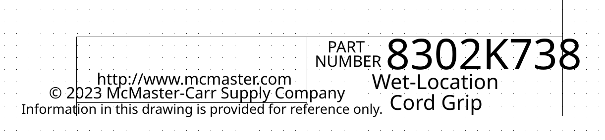

If you look at the “imperial” DXF from last week:
Which one matches the original sizes better?
I know that we won't be perfect with text-size, because for elements we have to round to integer numbers, but I think we should be as close to the original as possible!
Attachment icon Bildschirmfoto_2025-01-29_001_LibreCAD.png 4.92 kb, 63 downloads since 2025-01-29
Attachment icon Bildschirmfoto_2025-01-29_002_converted_with_original_dxf2elmt.png 51.77 kb, 72 downloads since 2025-01-29
Attachment icon Bildschirmfoto_2025-01-29_003_converted_with_modified_dxf2elmt.png 49.06 kb, 68 downloads since 2025-01-29

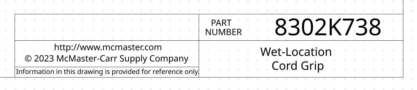

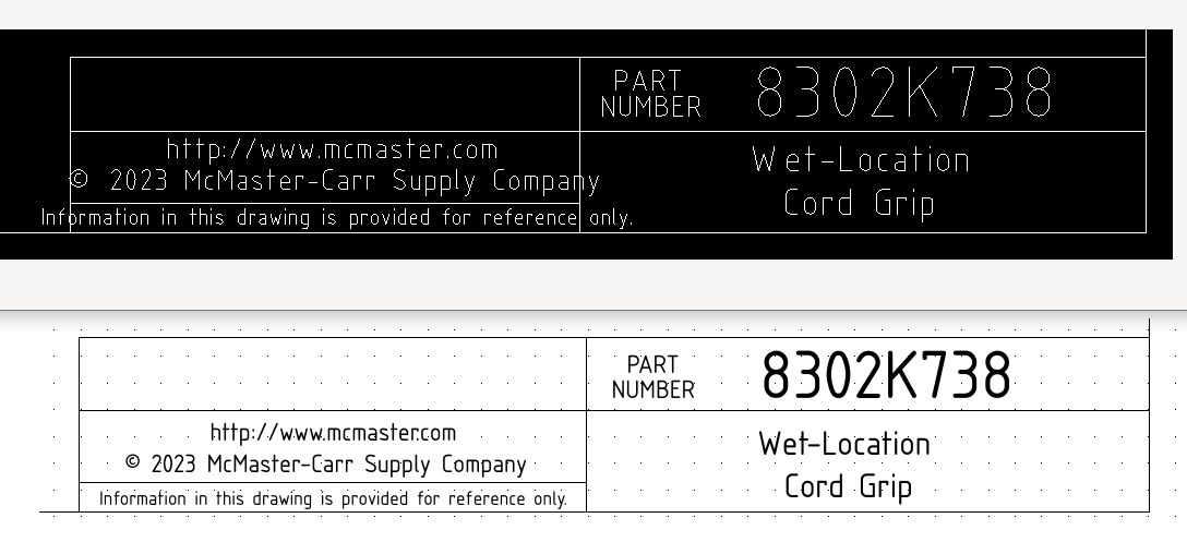

We are about to ship a few free fonts with QET. Among them is “osifont” which is often used as a font for CAD applications.
What do you think about specifying “osifont” as a font in converted elements for which no font is specified in the DXF?

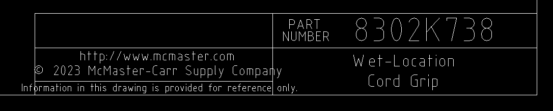

When I look at the title block of the well-known “Wet Location Grip” file in LibreCAD and compare the font with “osifont” in QET, the font fits much better than a sans serif font.
Would like to have attached a screenshot, but something's still wrong with forum-settings: I cannot attach a file!
osifont is a good decision, especially if it is used by other Card-Software. The DXF Export Function of QelectroTech is very important and a lot of users need it.
I've never heard of IS0 3O98, it looks like it's mostly a European thing, but it looks similar to other fonts I've seen used by AutoCad even outside of the Europe. I agree based on that screenshot you sent it does look a lot closer to what is being used by CAD that the Sans Serif font. Setting the default to "osifont" should be pretty straight forward. I'll see if I can do it tonight.
