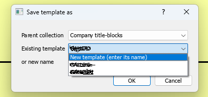

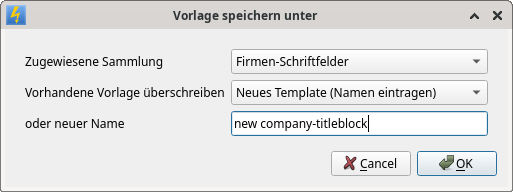

5 (edited by plc-user 2024-12-17 18:38:44)
Re: company title block
If I understand your problem correct, you have to choose "New template (enter its name)" and then you can edit the filename.
see screenshots
I use latest QET dev-version with Debian/GNU Linux (unstable).
Attachment icon Bildschirmfoto_2024-12-17_save_new_tb-template.png 20.95 kb, 58 downloads since 2024-12-17
Attachment icon Bildschirmfoto_2024-12-17_titleblocks.png 6.59 kb, 63 downloads since 2024-12-17

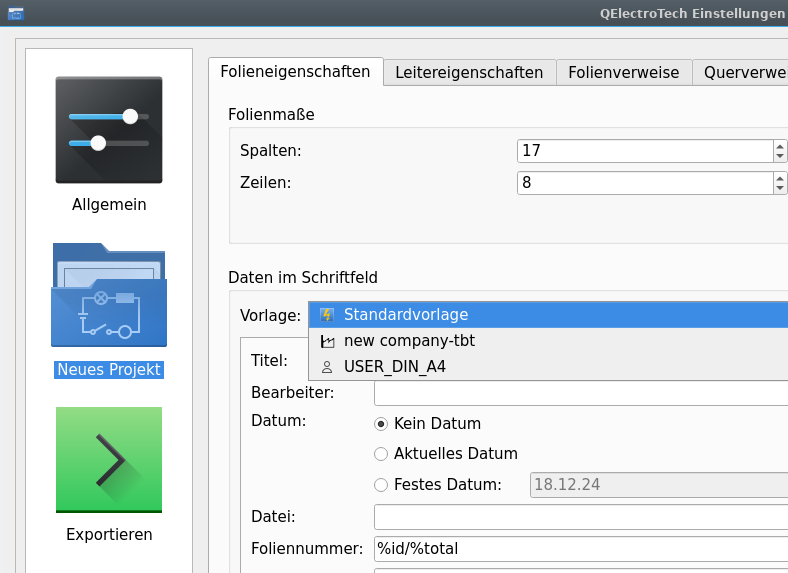

In QET-Settings for new projects you find ALL titleblock-templates from ALL collections to choose from.
In project- or folio-settings you only find templates that are available in the project:
Drag the newly created template from the tree to a folio to add it to the project. Then you can also choose from the dialog, which template to use.
in the QET configuration I only see the qet title block and user title blocks
the company title blocks are not available
so I can not set a company title block as default
as work around I can drag the wanted title block the new project and then set as template in the project
but this feels like a workaround

10 (edited by plc-user 2024-12-18 16:11:06)
You are right, Lieven, the ComboBox with the list of ALL templates isn't filled with the company-templates!
Sorry for confusion!
I am already on the search in the sourcecode, where this is going wrong...
But in the meantime you can use the "workaround"!
EDIT:
Found, where it went wrong! (see attachment)
Will create a pull-Request on GitHub!
