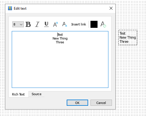

Now there may be an easy answer to this question (I hope) but I cannot get text to obey centering in the text editor for the normal drawing workspace.
I have tried both CSS and HTML, which the editor observes, however does not translate to the text field on the drawing.
Is there a way to center multiple lines of text in a text box? The next option might be to create an HTML table but that's a lot of effort to get centered text.
See attached screenshot for example.
Cheers

The HTML support is limited by the Qt toolkit.  You might want to check https://doc.qt.io/qt-5/richtext-html-subset.html for the tags and styling it supports.

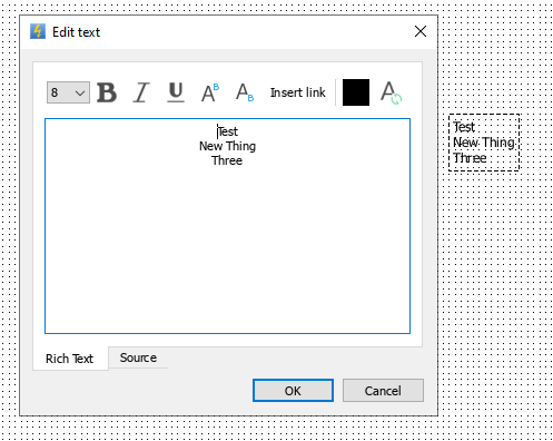

Why not use space to center text, no need to use avanced text editor and HTML?
https://download.qelectrotech.org/qet/forum_img_2/text_centering.png
