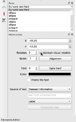

5 (edited by hairy_kiwi 2024-09-30 12:09:25)
Re: Creating new element and importing dxr file
5. In element editor how to group all items together since when I use this element in schematic the texts of that element changing position.
There's no ability to group element components as such, instead, try turning off (unselecting) Maintain visual rotation (see image below) of each text field.
Unselecting Maintain visual rotation causes an element's text fields to remain orientated according to the element's original layout.
Devs, if you read this: I think possibly the wording "Maintain visual rotation" is a little unintuitive (A tick box labelled 'Rotate text with element' - and logic configured in the opposite sense) might be more intuitive. It might also be nice to be able to user-select the default logic for element text in a system wide config file, but just ideas - for another time. nomicons/smile
