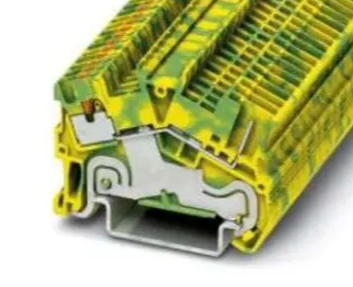

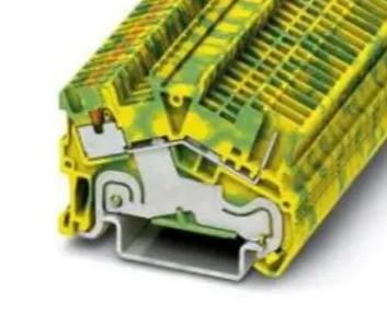

Is there a library part for a Series Terminal Block with different Size?
2025-01-24 08_21_32-Phoenix Contact3214479 PTS 1.5_S_1P-PE Series Earth Terminal Block, 0.14 → 1.5mm.png, 227.26 kb, 353 x 287
2025-01-24 08_21_32-Phoenix Contact3214479 PTS 1.5_S_1P-PE Series Earth Terminal Block, 0.14 → 1.5mm.png 227.26 kb, 111 downloads since 2025-01-24

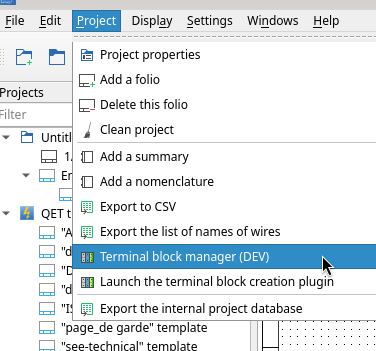

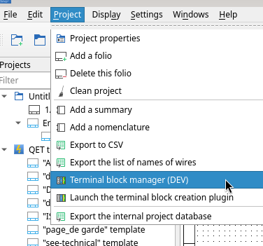

Re: Different wires connected to the same terminal
Please start a new thread in an appropriate forum, when changing topic...
When this is what you mean:
Use Terminal Block-Manager or Terminal-Block-Plugin.
Bildschirmfoto_2025-01-24_TerminalBlockManager.png, 31.72 kb, 376 x 351
