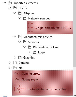

Hi All,
I have looked all over but cannot find a way of removing the embedded element information from a project even if the components have been removed. They show up in red but you cannot delete them. Is there a way of doing this
Thanks
Richard

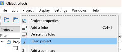

Project >> Clean project

Re: Removing embedded elements from a project
Brilliant, thanks you!
