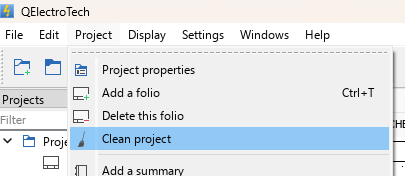

2 (edited by LievenC 2024-06-27 15:37:12)
Re: Removing embedded elements from a project
Project >> Clean project
Brilliant, thanks you!
