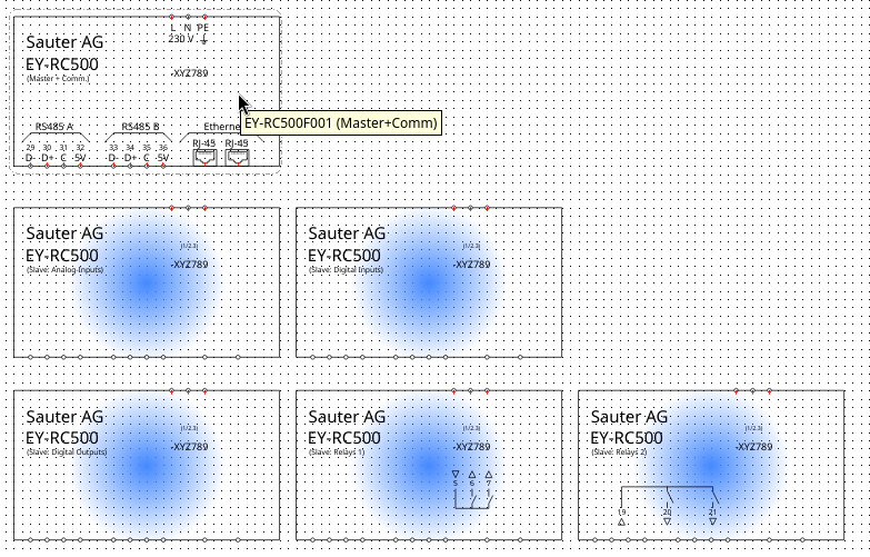

I share to you the .elmt for the Arduino Portenta Machine Control
Hope it's usefull
Do not hesitate to answer for adjustement nomicons/wink
Maybe the draw it's too small ? I don't know

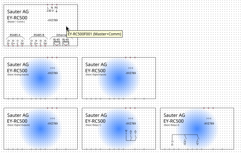

In my opinion:
Elements with so many terminals should be divided into several function groups and then added to the collection as master/slave elements.
For another case, I once suggested something like this from the appendix. The slave components are only roughly sketched and still need to be reworked, but that's roughly what I mean.
The manufacturer, designation and label for the slaves are dynamic texts that are filled from master-info, when connected.
[Edited]
And when it comes to automatic generation of cable-plans (https://qelectrotech.org/forum/viewtopic.php?id=2764):
The terminals need to have names.
You asked for feedback!  nomicons/wink
